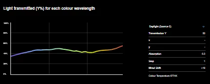

Oct 30, 2025 11:15 AM UTC
Thank you for the extra insights.
I am trying to create archive images of C19th prints at high resolution.
I am likely to be using Lee 239 polariser which has a published lumpy transmission curve
Obviously this will cause colour shifts across the whole spectrum and lightness.  The mired shift is single number which provides a compromise adjustment, and its calculation itself has number of compromises and assumptions.

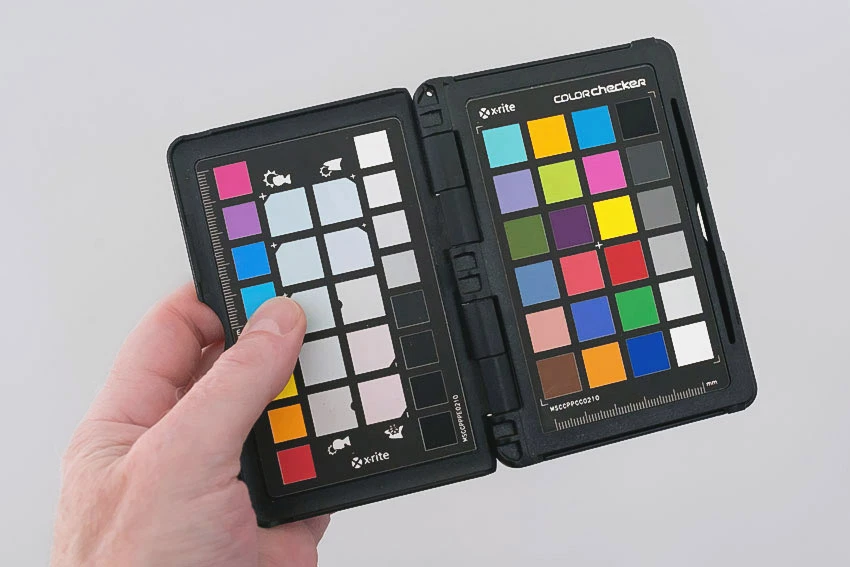

D Fosse
Oct 30, 2025 10:02 AM UTC
Just so we're all on the same page: mired is a unit for indicating color temperature shift, as the inverse/reciprocal of the Kelvin scale. It's a different way to express Kelvin values, in a way that makes it linear and evenly scaled so that it's easier to compensate a temperature shift.
So far so good. However, there is a fundamental problem here.
Color compensation needs to observe two dimensions, two axes, not just the blue-amber axis (K), but also the green-magenta axis. A color cast in a filter can be along either or both of these axes. Focusing only on one misses the other. Whether Kelvin or mired, it is only applicable to a series of dedicated temperature-compensating gels. It is not applicable to, say, a polarizer which is supposed to be neutral along both axes.
As you say yourself, the color of the light in the original scene cannot be known. As such, the only way to neutralize color is to make sure R=G=B in any patch that is supposed to be neutral. The concept of temperature is meaningless in a rendered finished image; it only applies to the original scene. So there is no temperature correction in Photoshop. It wouldn't make any sense.
(There is one in Lightroom/ACR, as a scale for compensating the original scene lighting, expressed rather arbitrarily in Kelvin numbers. But that's just an approximation and shouldn't be misinterpreted as "absolute" numbers.)
I've been working as a photographer at an art museum for over 20 years. Polarizers do a lot of things that need to be compensated, if the result is supposed to match the visual perception. Notably, they steepen the tone curve and increase saturation. Any color cast is corrected as part of the same process. You need a set of neutral patches with standardized Lab numbers to compensate for this, such as a common color checker chart:
