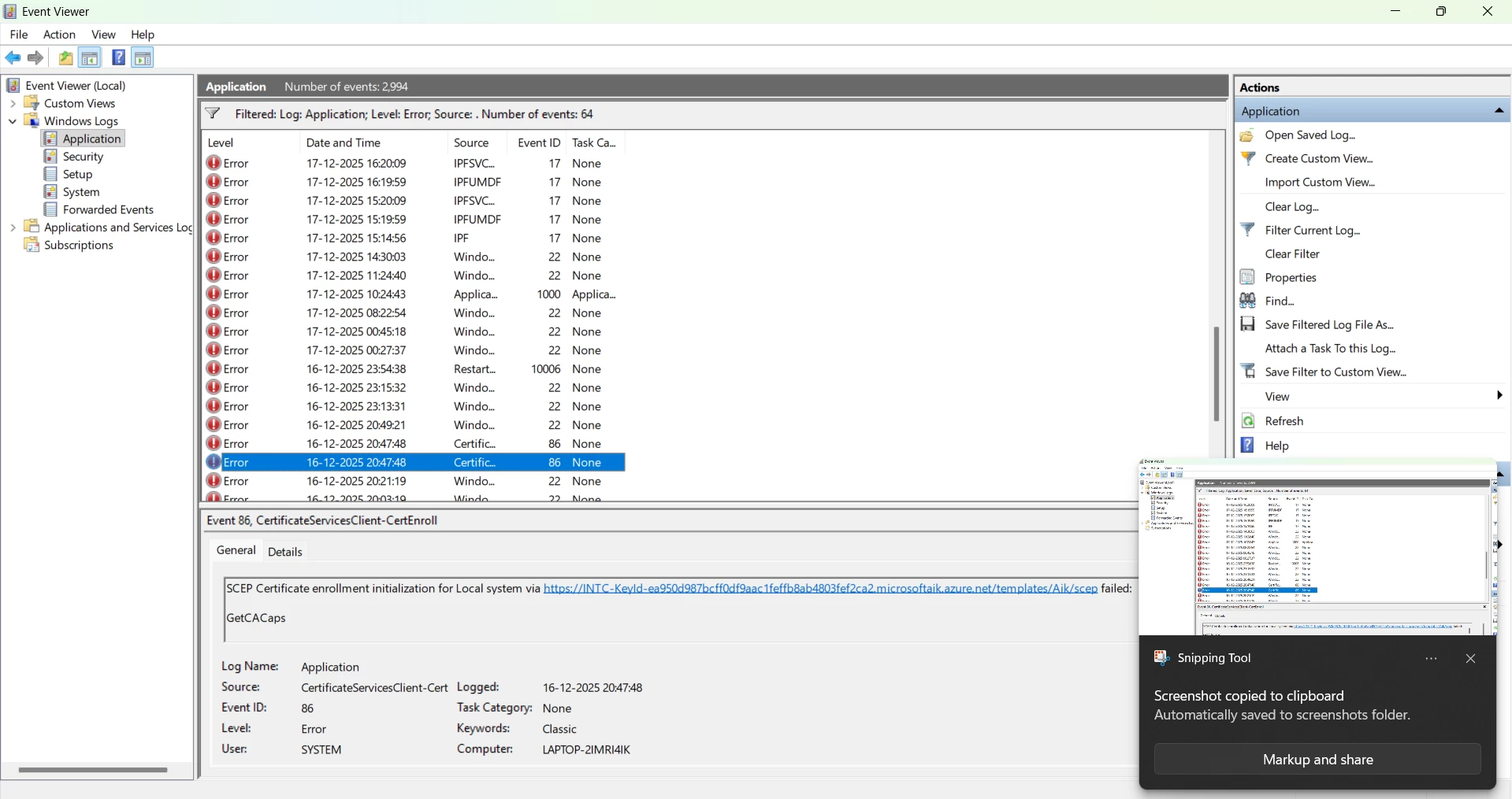

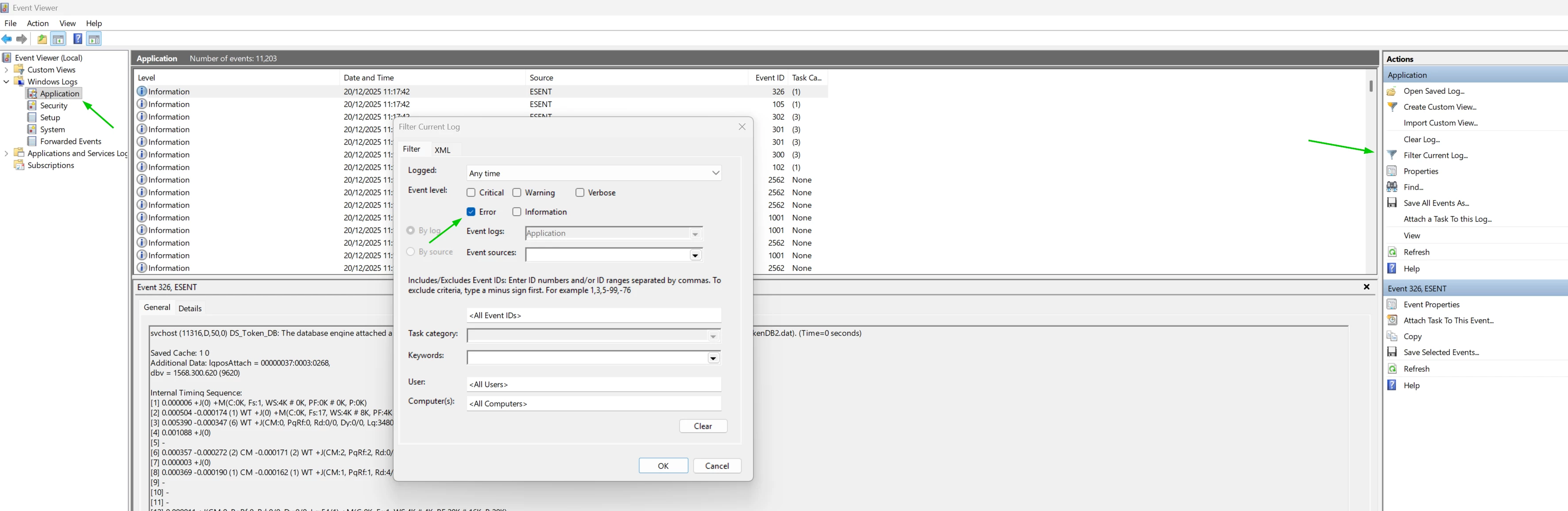

@Shivam_Wadhwa5670 have you checked Windows event viewer for errors relating to Photoshop.exe in the application log
Open event viewer, select Windows Logs > Application, on the right-hand side select Filter Current Log, then put a check mark in Error
Also can you post your Photoshop system info, in Photoshop go to Help > System Info, hit the copy button and paste the entire thing into this thread
