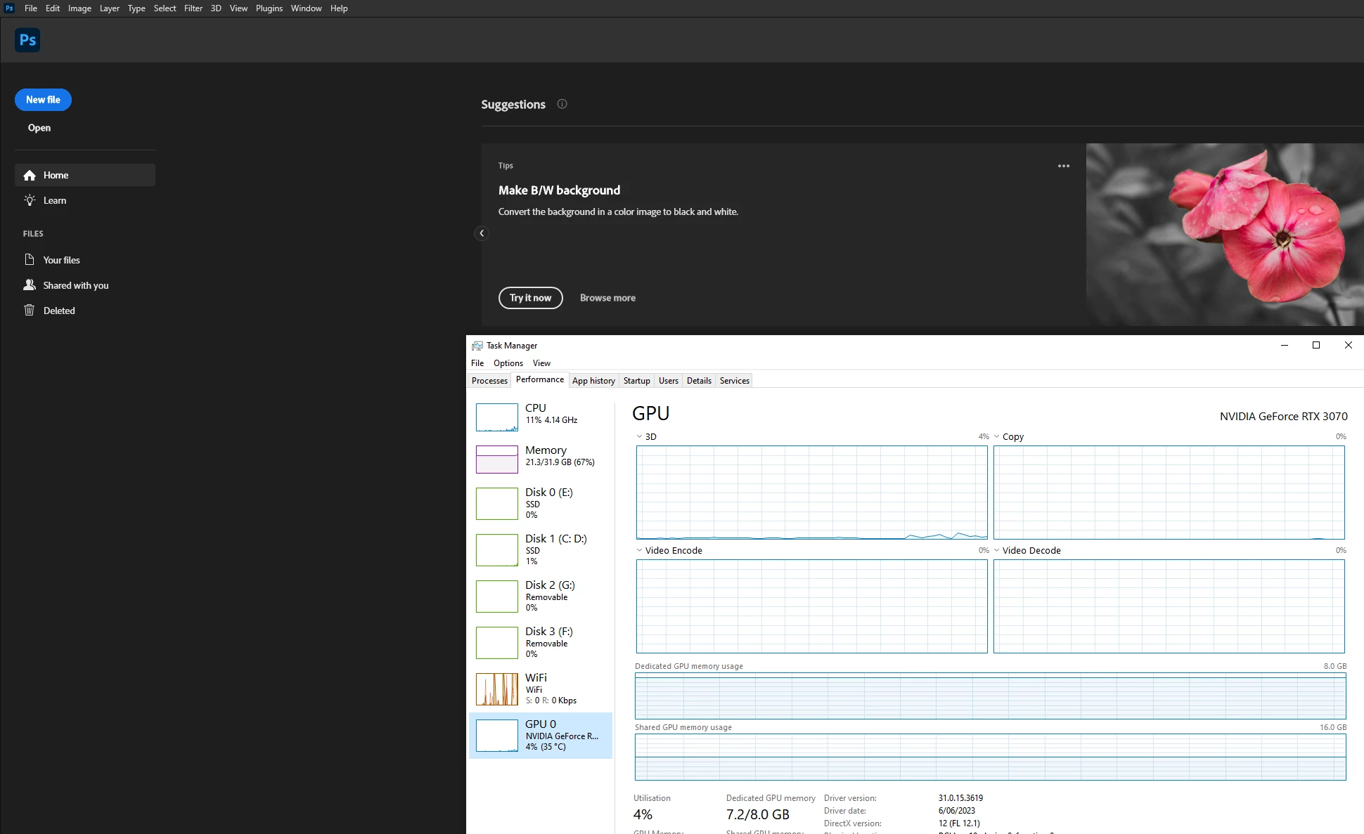

AI denoise tool in Camera RAW causes memory leak
The AI denoise function in Camera RAW utilises a great deal of video and system memory, which is not freed up once the image has been processed, or even when the processed image is no longer open in Photoshop. This causes delays to all GUI inputs, stops further images from being denoised (without swapping to system memory which makes the task take minutes rather than seconds) and causes red blocky artefacts to appear on exported images.
   In the attached image, there are no .PSD projects open, or images open in photoshop, however as displayed in Task Manager, nearly 8GB of VRAM and 21 GB of system memory are being utilised. (drops to 0.8 and 6.4GB respectively after closing PS).
   Closing and reopening will temporarily solve the issue. The rate at which memory leaks is highly variable. I may be able to process 12 images and keep the resultant .DNG's open in photoshop all the while. Today Camera RAW has only been able to process 3 images without subsequently opening them in Photoshop, before having too little VRAM to continue working.
   I rely on the AI denoise tool, it provides much better quality than traditional methods, any guidance would be much appreciated.

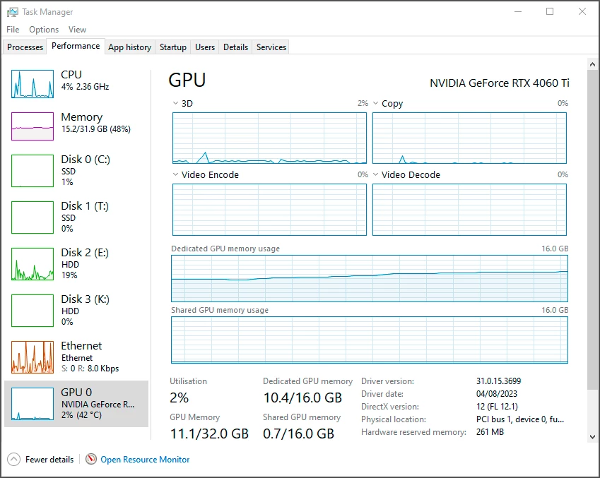

Denoising 6 x 60MP here, VRAM stays at about 10 GB throughout. I might get it a little higher with more files, but I haven't seen Denoise max it out fully.

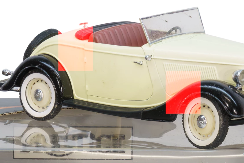

Here is a crop of an image demonstrating the red blocks, sometimes the artefacts are the same shape as a layer. Rolling back from v 25.0 to 24.2 did not resolve the issue.
