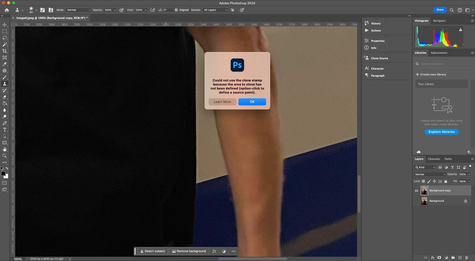

    Having the same issues with Photoshop 2024.
    November 8, 2023
    I'm having the same problem ever since I upgraded to Adobe Photoshop 2024. All my alt keys stopped working. HELP!!!!
    Kevin Stohlmeyer
    November 8, 2023
    @Peter26317478ei6h your replying on a 6 year old thread. Go to Apple system preferences/Security and Privacy/Full Disk Access and add and allow Photoshop to this list. PS does not have permissions to do an on-screen record (opt+click).

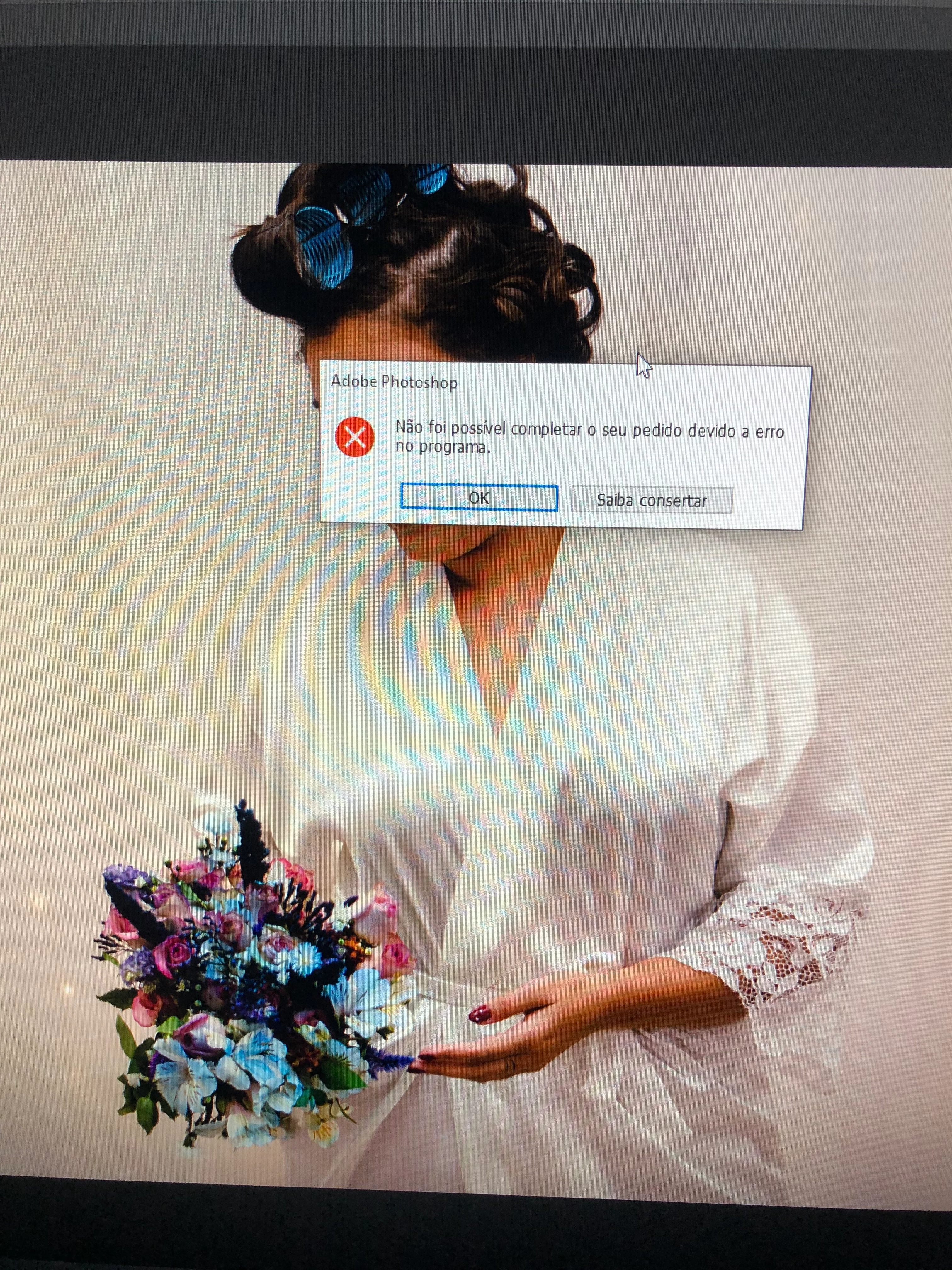

    June 26, 2022
    Estou com o mesmo problema sem solução a meses, última versão da esse erro, a anterior não , quando clico alt e carimbo ele aparece a mensagem de erro do programa e não consigo mais mexer em nada , tendo que finalizar tarefa . Lamentável
