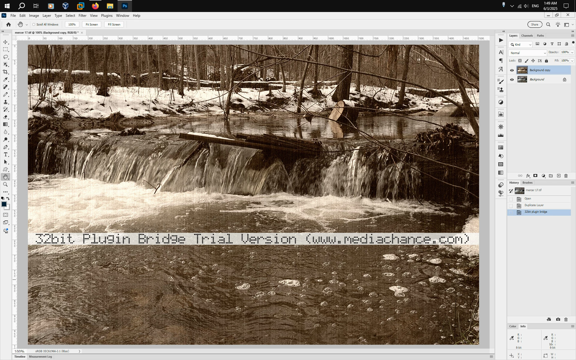

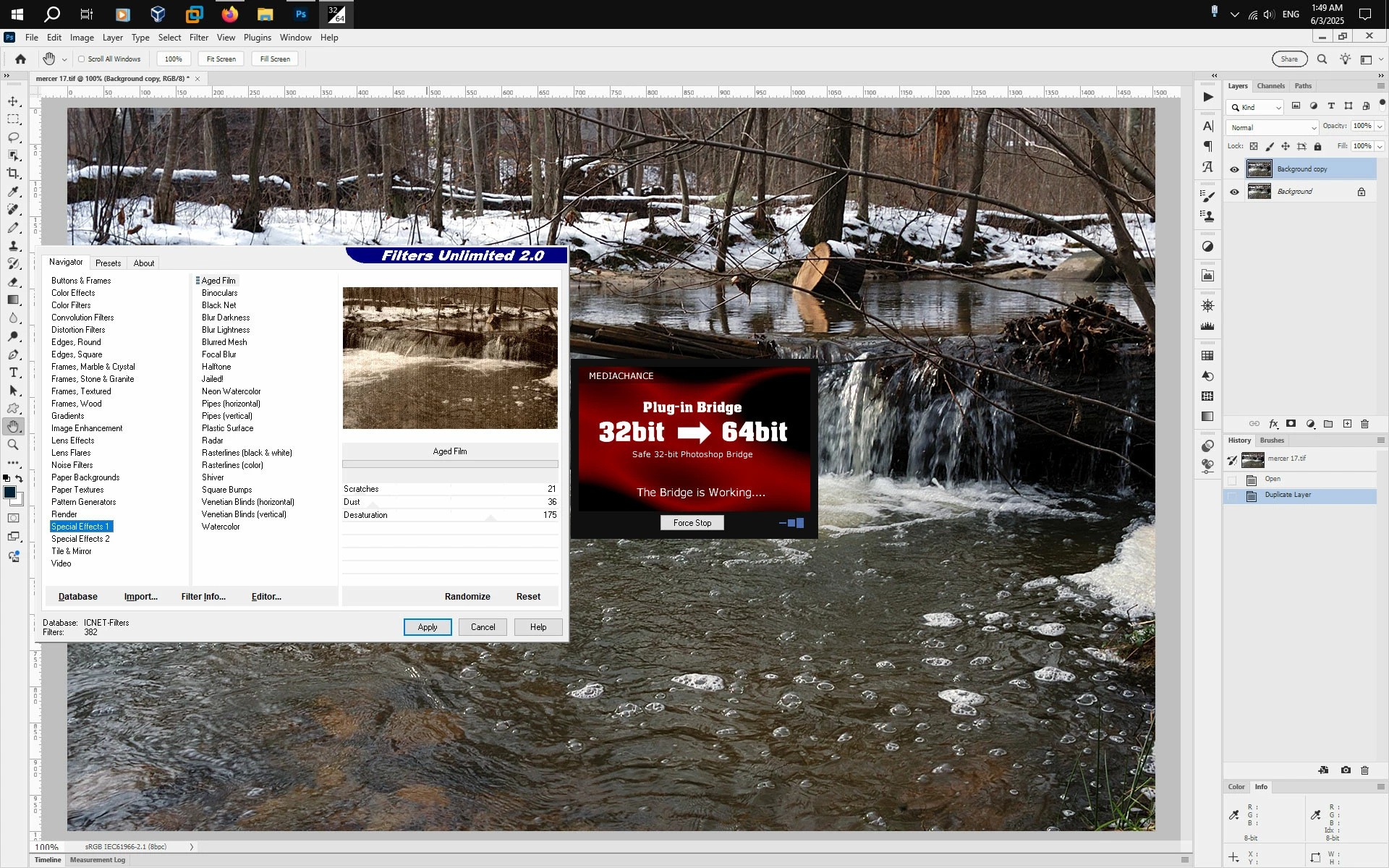

Filters Unlimited is a 32 bit plugin that perhaps runs best on a 32 bit host like Photoshop CS6 or older, however i did get it to work in Photoshop 2025 (ps ver 26.7) running on Windows 10 x64 22H2 by using a product called Plugin Bridge:
https://www.mediachance.com/pluginbridge

Jun 3, 2025 5:53 AM UTC
