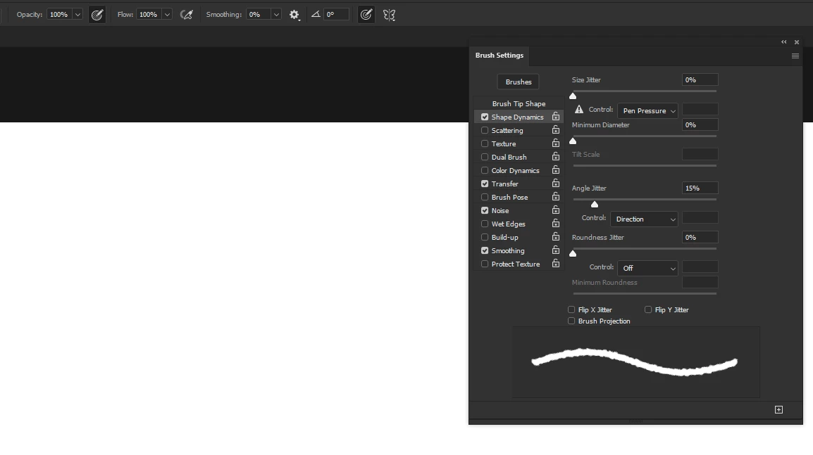

So the problem is that despite everything in brush settings should be correct (pen control enabled) for some reason PS keep setting "always use pressure for opacity" and "always use pressure for size" buttons ON

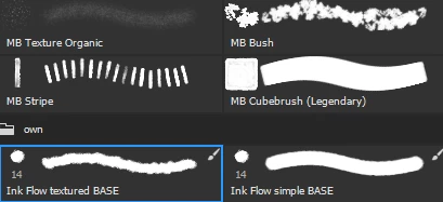

It's always turning on with brushes that have this little brush icon in right corner and then just keep working no metter I change brush with no icon.
Please help me, idk if it's a bug or I'm doing something wrong 😞

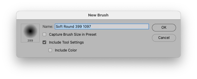

If whoever created the Brushes decided to »Include Tool Settings« then that is not a »bug« but the decision of the maker of the Brush.

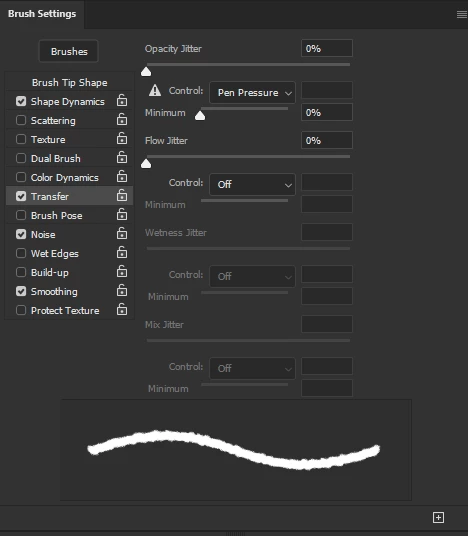

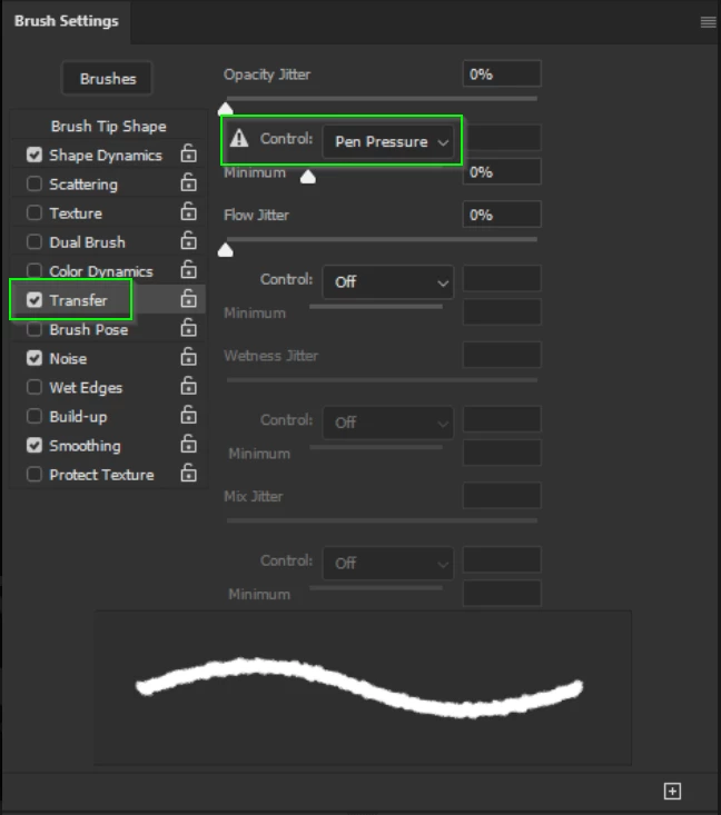

You have Transfer > Pressure controls opacity set in brush settings, but even with that, it shouldn't turn on the icon in the Options bar.

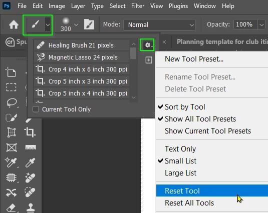

So, first off, with the Brush selected, reset as per this screen shot.
I think this probably won't fix it, so if that's the case, its going to be reset Preferences.  Always a pain, I know, but I feel like I have done this so many times now, it only takes fivew to ten minutes to get everything set again.
Manual reset is best, but try from the Preferences panel first if you like
