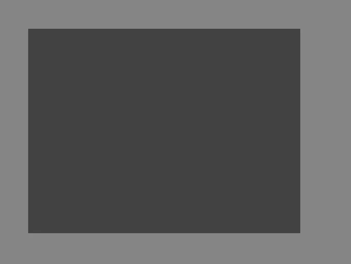

No, the pixels aren't stretched. Set the rectangular marquee to "fixed ratio" at 4:3, and just try for yourself.
Again, it's because the long side has more pixels, so a percentage increase adds more pixels on the long side than the short side. The border gets wider.
If you want an even width border, you don't get the same aspect ratio. As you keep adding, the rectangle becomes more and more square.
This is just the way geometry works. Both these are 4:3, just measure them if you wish:
