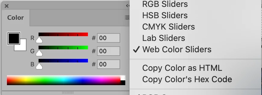

I've been trying naming every hex code from Wikipedia, & this annoying happened. Any ideas how to fix it, please?

The sliders are called "Web Color Sliders", not "Hex Color Sliders" and were added to the Color panel back in days when most folks had monitors with 256 colors, 216 of which were web-safe colors, and back then it was important to use them.

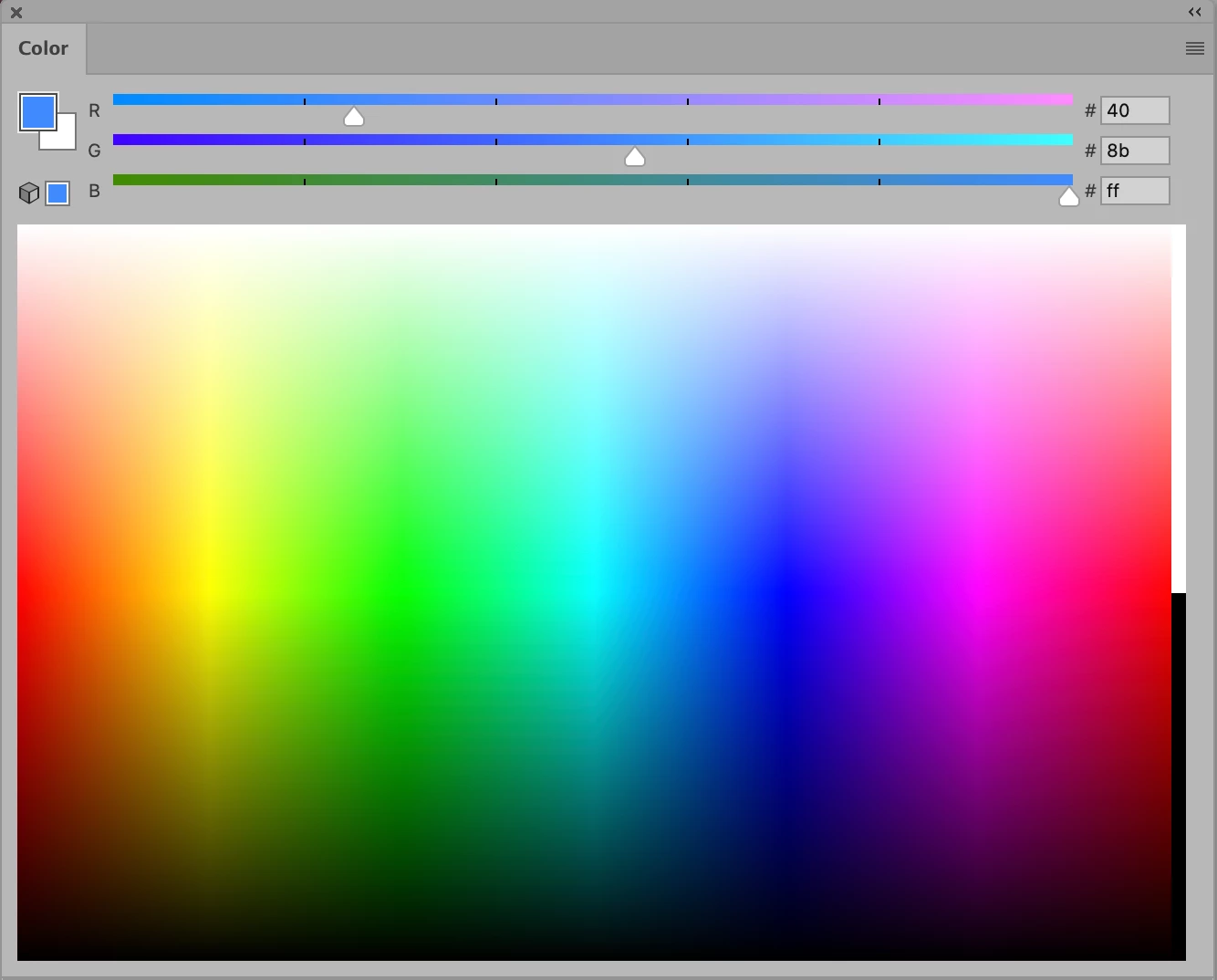

In addition to what's been said, you can:
  • type the numbers if you know them
  • click or drag in the ramp
  • resize the panel taller and wider to get a larger ramp

I tried, & it didn't work. Also, I think "Annoying safe colors" is a little bit rude, what do you call the black lines of the hex code sliders?
Jeff Arola
December 12, 2020
You can press the Option or Alt key while using a slider to keep from locking on the "Safe" lines.
