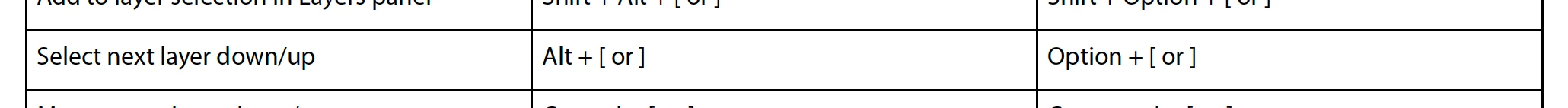

»I'm sure in the past I would end the action by selecting the next layer.«
Selecting the next Layer above or below can be done via Keyboard Shortcut and I think it should record in an Action.

The key is option + '[' to layer down.
Now Ive sorted that, how can I get the action to automate over every layer as opposed to pressing play for every layer?
