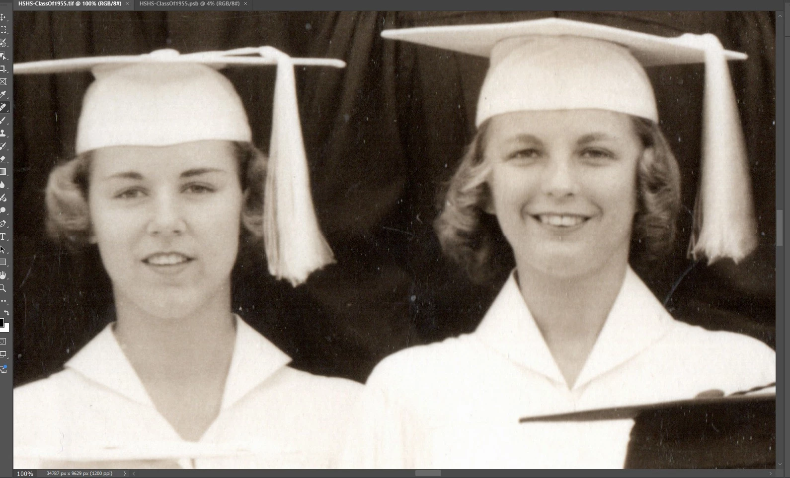

November 7, 2024
Just a very small version of what I am working on...
