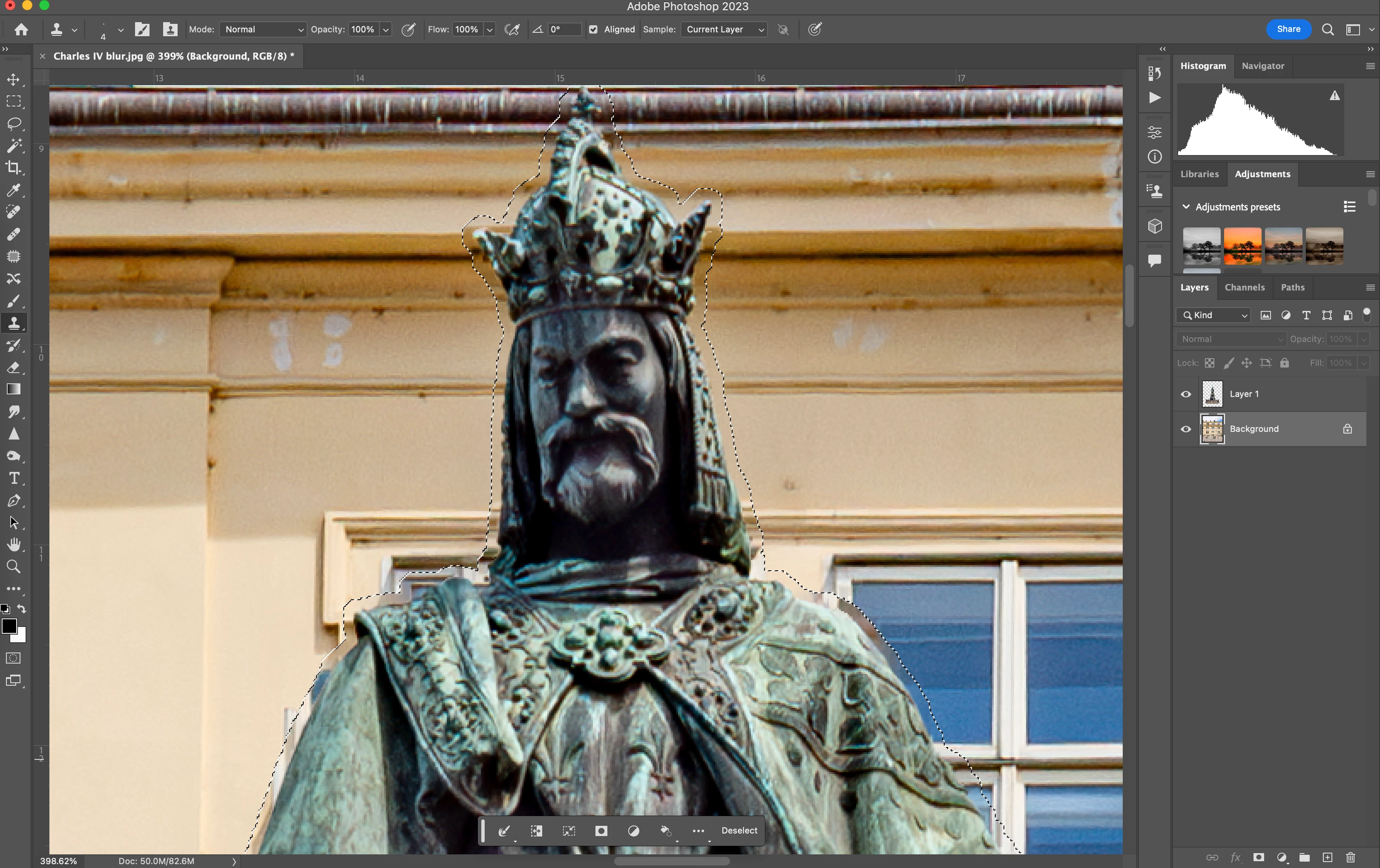

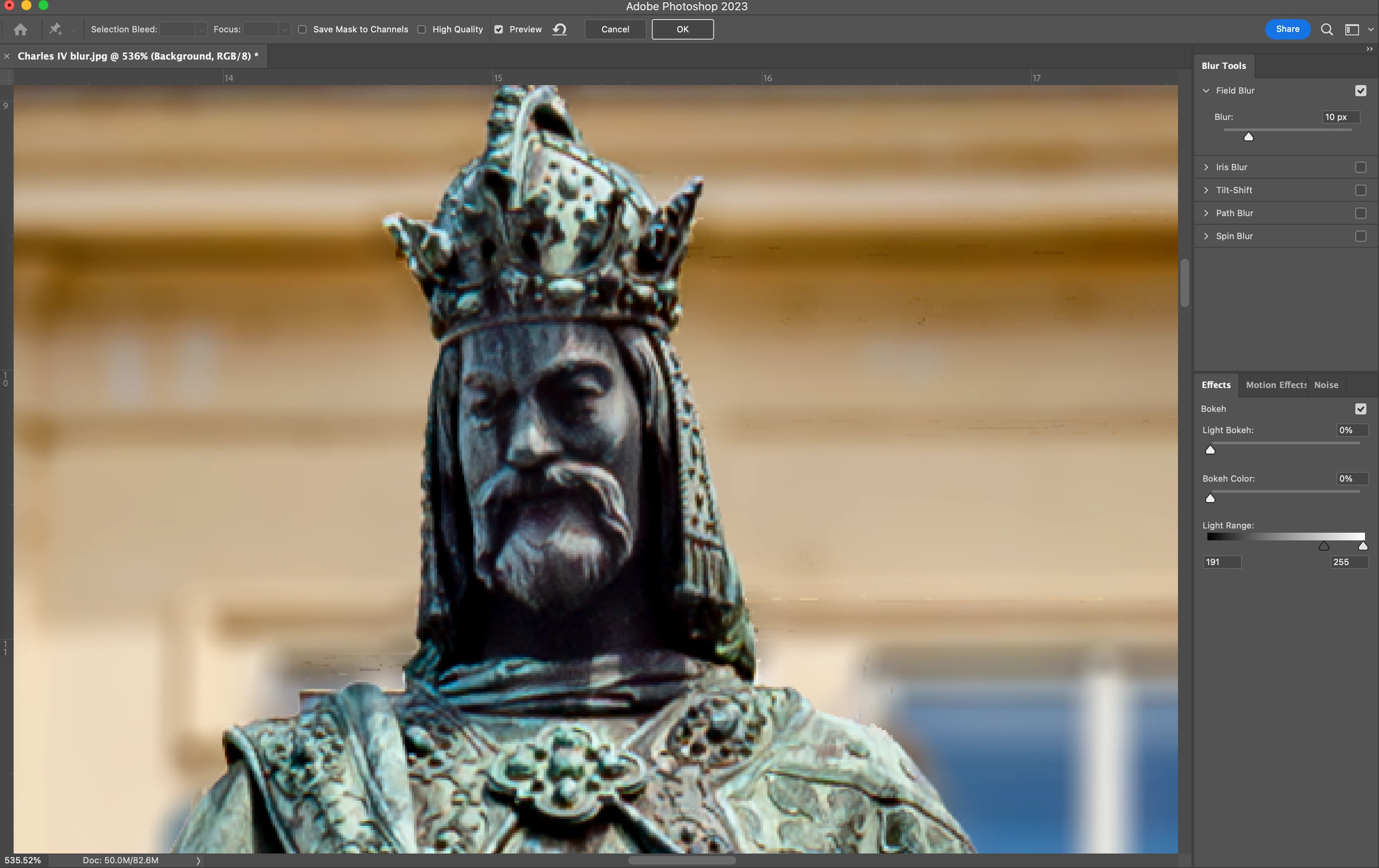

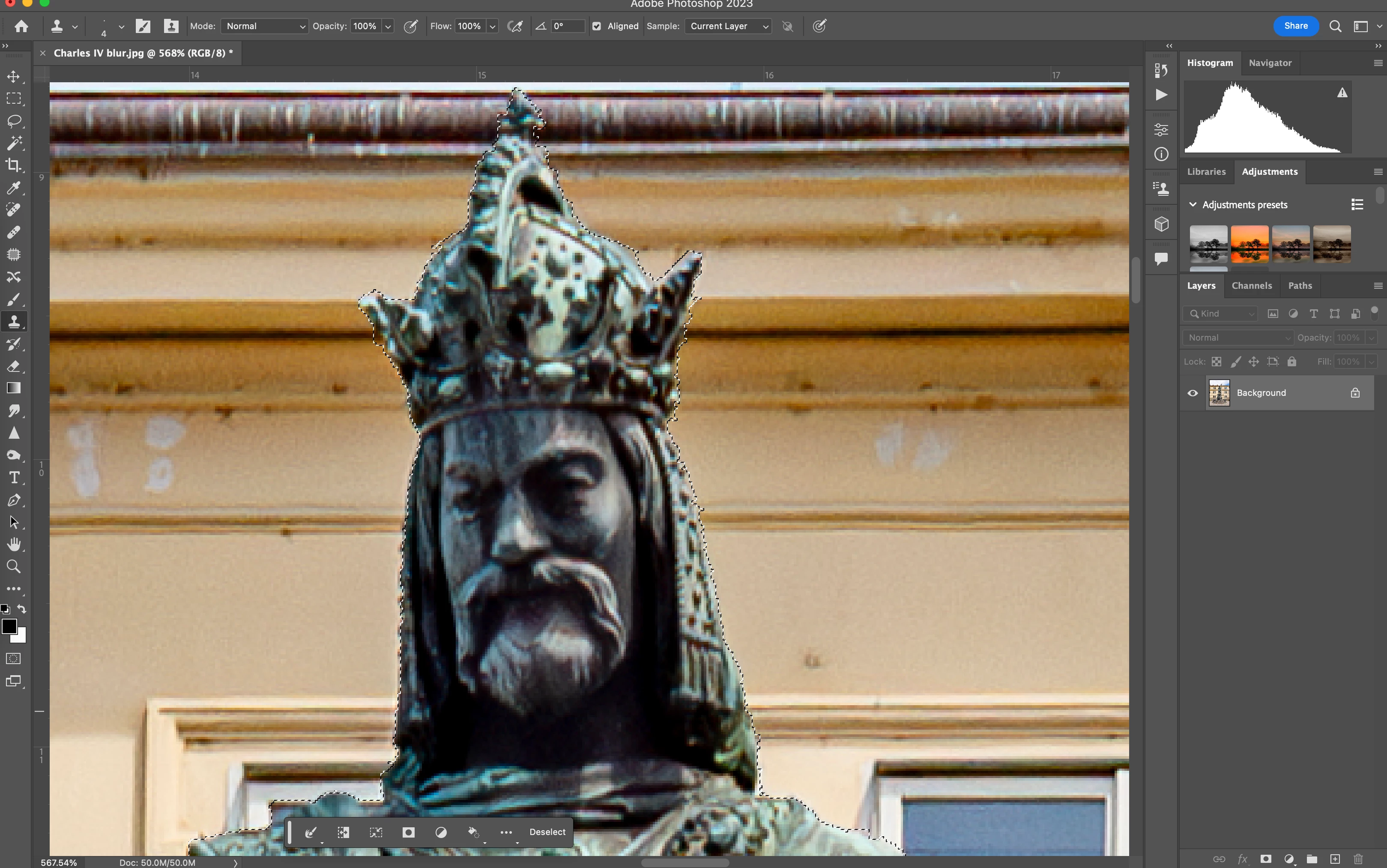

Attached are screenshots of the problem I am having. The image is zoomed in to show the detail of the issue.

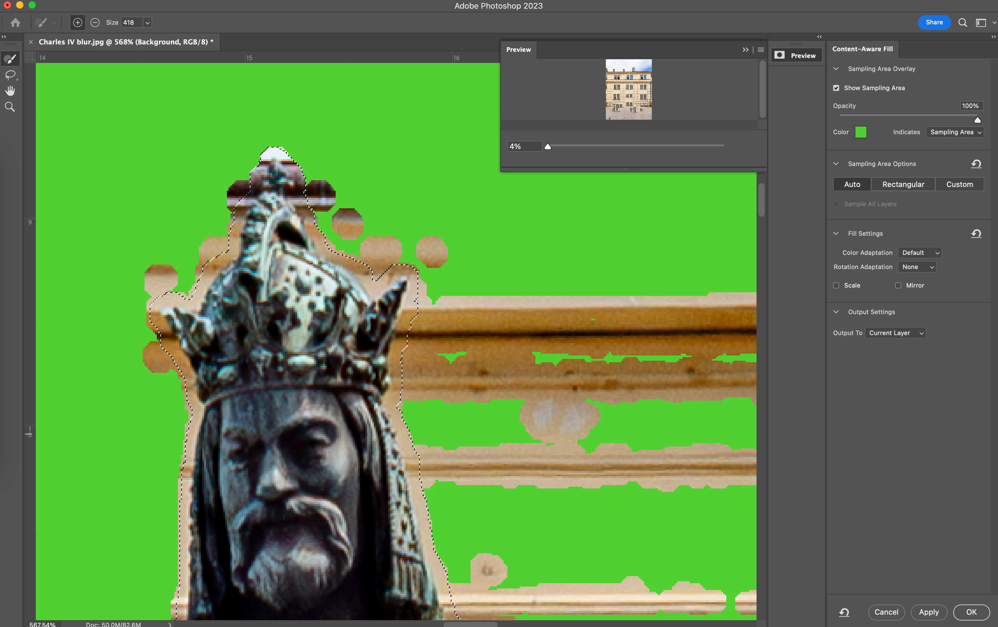

I want to apply a slight field blur to the building in the background of the statue. I spent a lot of time selecting the statue. I then used Cmd+J to get it to a layer.  I then expanded the selection and then content-aware filled it in (to avoid any halo from the blur). Then Cmd+D and apply field blur. But, I am getting bizarre artefacting each time I apply the blur. These artefacts appear to be similar to what appears on the content-aware fill screen, so I presume the errors are already present by then. I have tried this multiple times and it keeps happening in the same spot. What's going wrong with my selection? It is like it is ignoring my selection somehow.

@Mllejules Hi, I hope I've understood correctly, it would be useful to have close-ups of an area of your image pre and post blur so we can see the artifacts clearly
As this a Jpeg image, those could easily be Jpeg artifacts - since you are blowing it up massively on-screen (568%), those are kinda inevitable.
Just as a test please try a whole number view, say 500% rather than 568% which will give you a more accurate view of your image content (but I doubt it will disappear the artifacts).
It could be that when you take this image back down to 100%, the artifacts you have will not be visible. I hope you're not planning to use it above 100% as that's when artifacts start to show themselves - even in some unmodified Jpegs.
