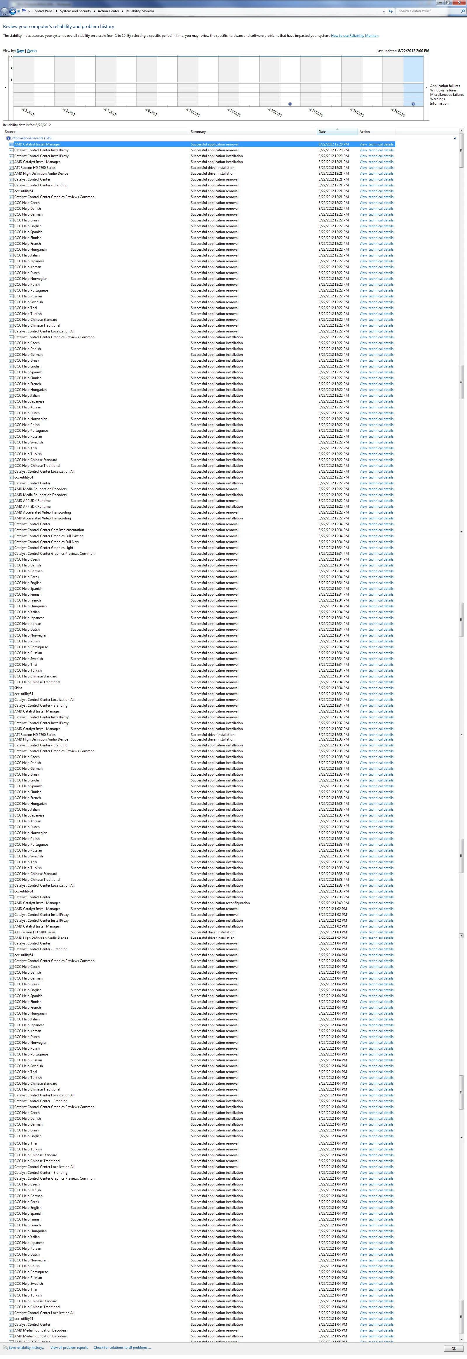

    I had a very old ATI drivers so I though why not update.  I think I had 10.9 installed. I updated to 12.2 tough the drivers seem to work well the Catalyst Control Center crashes nevet put anything on screen. So I updated to 12.4 thing are the same CCC crashes. Installed 12.8 drivers seem to work well ADM I have installed work as does Photoshop to the best of its ability.  CCC.exe crashes.  Any idea as to how I can get Catalyst Control Center operational? I did see a very old ATI entry in the control palem Programs and removed that and the reinstalled 12.8 CCC still crashes on me..  In the programs all I see is AMD Catalyst Install Manager and the two AMD demo Ladybug and Mecha I have a HD 5770.
    In the windows start meme the a Catalyst Control Center shortcut for "C:\Program Files (x86)\ATI Technologies\ATI.ACE\Core-Static\CCC.exe" as well as in the widows right click popup window. Window 7 Pro 64bit
