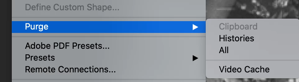

Do you have enough memory? How about your scratch disk?
You can go to editL Purge and purge meory.

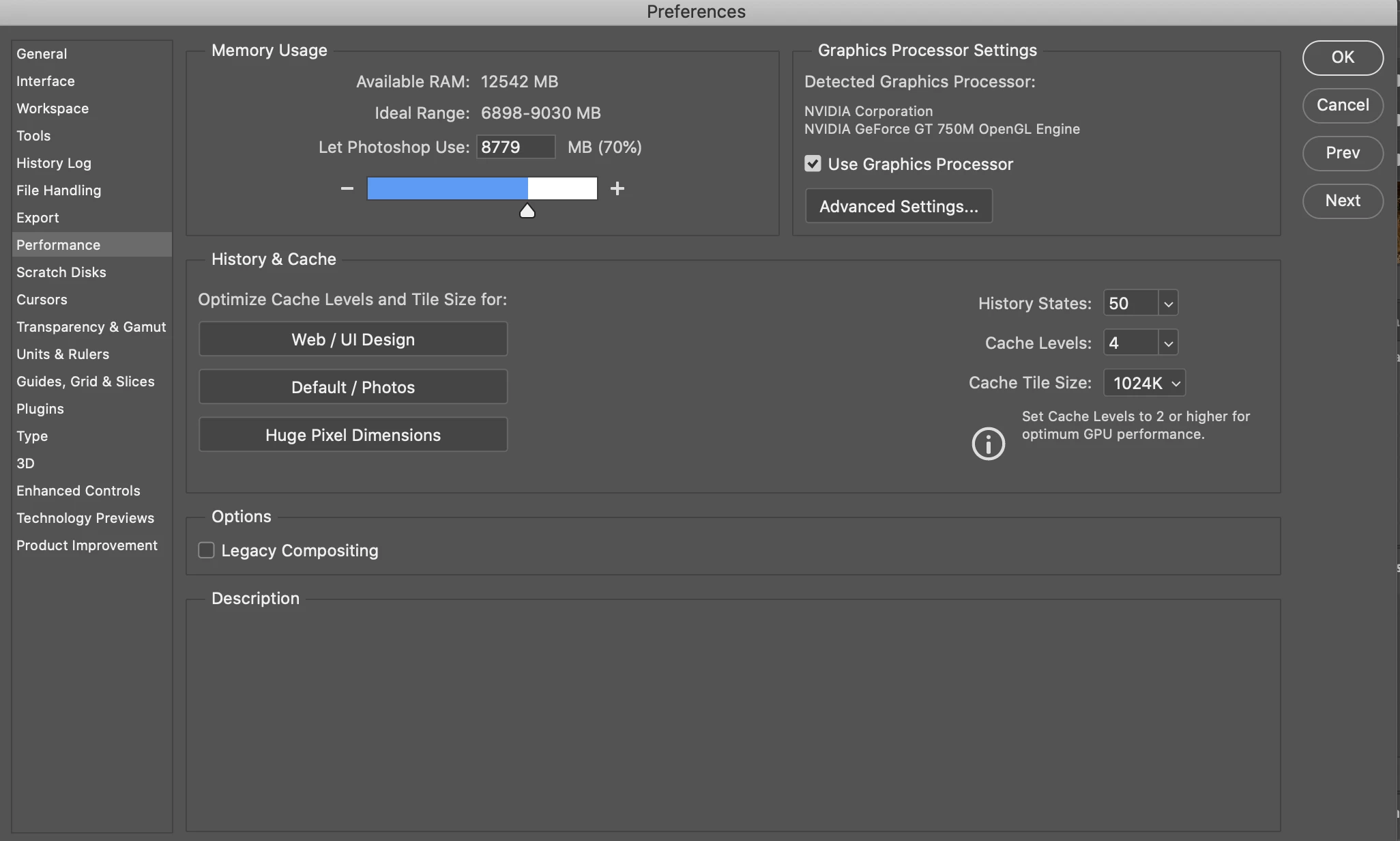

Another one is to go to prefences and turn on the Graphics Card.
Also turn off the saving in background and saving temp files.
