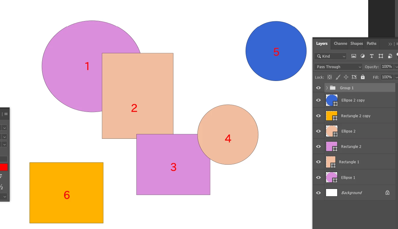

I'm working with Photoshop 22.0.0 and I have a PSD containing more than 1000 dividual shape layers (vector layers). Many of these shapes overlap each other. For example:
Even if Shape 1 does not directly overlap Shape 4, they should all be considered part of the same connected group. So I need a Photoshop script that works as follows:
  1. When I selects a single Shape Layer, the script will find all Shape Layers that overlap the selected layer.
  2. All layers in that connected group should be merged into a single Shape Layer. Layers that are not connected to the group must remain untouched.
  3. The final merged shape should use the appearance (fill/stroke/style) of the originally selected Shape Layer.
Thank you for your all help!

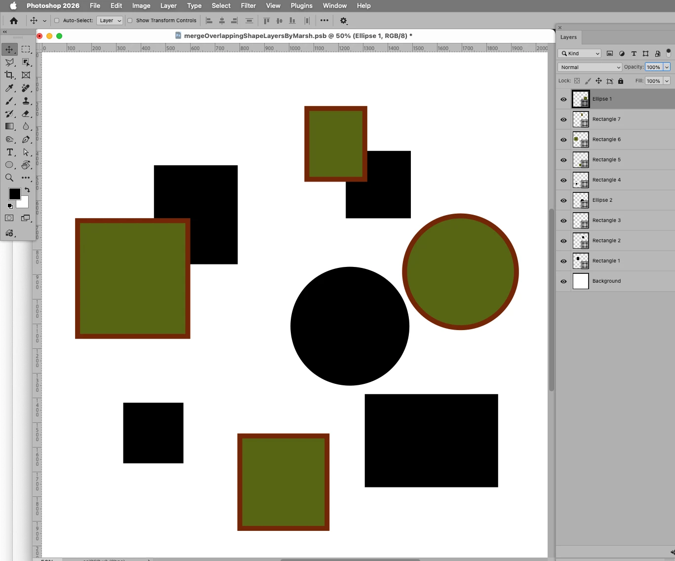

    Here is a first draft, it doesn't explicitly work with groups, it only works on the root-level layers.
    * Select And Merge Overlapping Visually Connected Vector Layers.jsx
    * Stephen Marsh
    * v1.0 - 7th June 2026: Initial release
    * https://community.adobe.com/questions-712/auto-merge-overlaps-vector-layers-1626768
    * 1. From the one selected vector shape layer ("target layer"), the Breadth-First Search (BFS)
    * finds all visually connected (overlapping) vector shape layer "components".
    * 2. If the target layer has a layer style, copies it via AM copyLayerStyle.
    * 3. Moves the target layer layer to the top of the components stack, as the
    * top layer in the stack, as the merge retains the fill and stroke properties.
    * 4. Selects the whole connected components, merges them into one shape layer
    * (keeps vectors live with an option to destructively combine).
    * 5. If a layer style was captured, pastes it via AM pasteLayerStyle.
    * Only vector shape layers are selected. Pixel, text, smart-object and
    * adjustment layers are completely ignored throughout.
    app.activeDocument.suspendHistory("Select And Merge Overlapping Visually Connected Vector Layers", "main()");

    Stephen Marsh
    Stephen MarshCommunity ExpertCorrect answer
    Jun 7, 2026 4:22 PM UTC
    * Stephen Marsh
    function main() {
    // Debug: set true to show a layer-bounds report before BFS
    var DEBUG = false;
    // 1. Checks
    var doc;
    try { doc = app.activeDocument; }
    catch (e) { alert("No document is open."); return; }
    var selectedLayers = getSelectedLayers(doc);
    if (selectedLayers.length === 0) {
    alert("No layers are currently selected."); return;
    if (selectedLayers.length > 1) {
    alert("Please select exactly ONE vector layer before running.\n" +
    "Currently selected: " + selectedLayers.length + " layers."); return;
    var targetLayer = selectedLayers[0];
    if (!isVectorLayer(targetLayer)) {
    alert("\"" + targetLayer.name + "\" is not a vector shape layer.\n" +
    "Please select a vector shape layer and try again."); return;
    // 2. Collect all vector layers (flat, no groups)
    var allLayers = [];
    collectVectorLayers(doc.layers, allLayers);
    if (allLayers.length < 2) {
    alert("There is only one vector layer in this document - nothing to connect."); return;
    // 3. Bounding box cache
    var bounds = [];
    var targetIndex = -1;
    for (var i = 0; i < allLayers.length; i++) {
    bounds[i] = safeBounds(allLayers[i]);
    if (allLayers[i].id === targetLayer.id) { targetIndex = i; }
    if (targetIndex === -1) {
    alert("Could not locate target layer in vector list: " + targetLayer.name); return;
    if (DEBUG) {
    var dbg = ["Vector layers (" + allLayers.length + "):\n"];
    for (var d = 0; d < allLayers.length; d++) {
    var bd = bounds[d];
    dbg.push(allLayers[d].name + (bd
    ? " [L:" + Math.round(bd.left) + " T:" + Math.round(bd.top) +
    " R:" + Math.round(bd.right) + " B:" + Math.round(bd.bottom) + "]"
    : " [no bounds]"));
    alert(dbg.join("\n"));
    // 4. Copy layer style from target (if it has one)
    // Use AM copyLayerStyle while the target layer still exists.
    // The boolean controls whether to paste later.
    var hasCopiedStyle = false;
    if (hasLayerStyle(targetLayer)) {
    copyLayerStyle(targetLayer);
    hasCopiedStyle = true;
    // 5. Alert target layer
    /* alert("Initially selected layer:\n\n \"" + targetLayer.name + "\""); */
    // 6. BFS
    var visited = [];
    var queue = [];
    var component = [];
    for (var k = 0; k < allLayers.length; k++) { visited[k] = false; }
    visited[targetIndex] = true;
    queue.push(targetIndex);
    while (queue.length > 0) {
    var current = queue.shift();
    component.push(allLayers[current]);
    for (var j = 0; j < allLayers.length; j++) {
    if (!visited[j] && boundsOverlap(bounds[current], bounds[j])) {
    visited[j] = true;
    queue.push(j);
    // 7. Alert connected component
    var names = [];
    for (var n = 0; n < component.length; n++) {
    names.push(" \"" + component[n].name + "\"");
    if (component.length === 1) {
    alert("This vector layer has NO visually connected neighbours.\n\n" +
    "Selected layer:\n" + names.join("\n"));
    return; // nothing to merge
    /* alert("Found " + component.length + " visually connected vector layer(s).\n" +
    "All are now selected:\n\n" + names.join("\n")); */
    // 8. Move target layer above all other component layers
    // Photoshop's "Merge Shapes" merges into the topmost selected layer, so we
    // move the target to the top of the component stack before selecting/merging.
    // That guarantees the target layer survives as the merge target and its name,
    // fill and or stroke is kept on the resulting merged shape layer.
    moveTargetAboveComponents(targetLayer, component);
    // 9. Select the component in the Layers panel
    selectLayersById(component);
    // 10. Merge shapes (Edit > Merge Shapes keeps paths live)
    mergeSelectedShapes();
    // After merge, the new combined layer becomes the active layer
    var mergedLayer = doc.activeLayer;
    // 11. Paste layer style onto the merged layer (if targetLayer had one)
    if (hasCopiedStyle) {
    pasteLayerStyle(mergedLayer);
    // 12. End of script notification
    app.beep();

    c.pfaffenbichler
    Jun 8, 2026 6:20 AM UTC
    I think the bounds can be a tricky property in this case.
    Stephen Marsh
    Jun 8, 2026 6:52 AM UTC
    ​@c.pfaffenbichler I agree, as no file was provided for testing, what I built for proof of concept testing was rather simple.
    Stephen Marsh
    Jun 7, 2026 11:27 AM UTC
    ​@Junyi24858697x32l
    This is not an easy task! I'll take a look at it, but I can't promise anything...
    c.pfaffenbichler
    Jun 7, 2026 3:22 PM UTC
    I expect it would be possible to check the Bounds of each pair of Shape Layers against each other and, if there is a Bounds-overlap, to check each path segment of the two paths for intersecting,
    The Selection-route would probably take too long for a file with more than 1000 Shape Layers.
    ​@Junyi24858697x32l , does each Shape Layer contain only one subPathItem?
