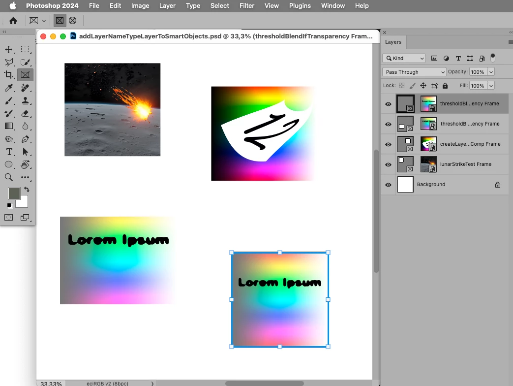

If you create a template with frames, populate it with the images you can use a relatively simple script to add the names as Type Layers.
// add type layer with smart objects’ names;
// 2024, use it at your own risk;
if (app.documents.length > 0) {
// set to pixels;
var originalRulerUnits = app.preferences.rulerUnits;
app.preferences.rulerUnits = Units.PIXELS;
// process;
var theSO = collectSmartObjectsBounds ();
for (var m = 0; m < theSO.length; m++) {
var thisOne = theSO[m];
addTypeLayer (thisOne[0], [thisOne[2][0]+(thisOne[2][2]-thisOne[2][0])/2, thisOne[2][3]+35])

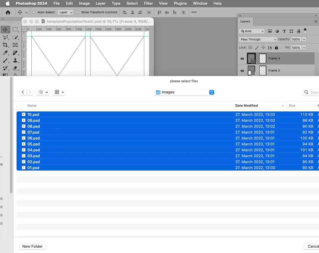

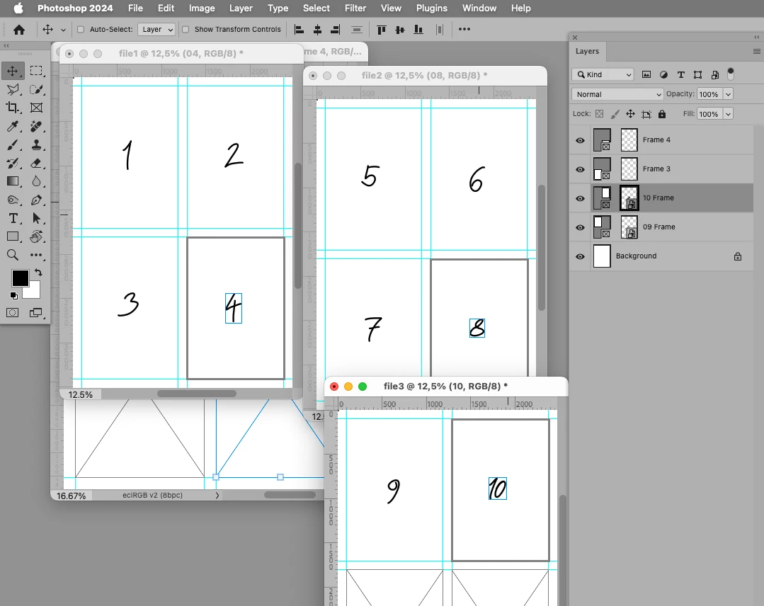

By @Adi1231234
Once you have set up a template with Frames (for example) a Script to populate those with images need not be too complex, depending on what you want to achieve.
// fill frames in duplicate/s of active document with selected images;
var theFiles = selectFile (true);
var myDocument = activeDocument;
var theCount = 0;
var thePages = 1;
var theCopy = myDocument.duplicate("file"+thePages, false);
var theFrames =  collectFrames ();
for (var m = theFiles.length-1; m >= 0; m--) {
    fillFrame (theFrames[theCount][2], theFiles[m]);
    theCount++;
    if (theCount == theFrames.length) {
        theCount = 0;
        thePages++;
        activeDocument = myDocument;
////// frame //////
function fillFrame (theFrame, theFile) {
selectLayerByID(theFrame,false);
var idpixelsUnit = stringIDToTypeID( "pixelsUnit" );
var idplaceEvent = stringIDToTypeID( "placeEvent" );
var idlayer = stringIDToTypeID( "layer" );
var idoffset = stringIDToTypeID( "offset" );
var desc7 = new ActionDescriptor();
    desc7.putInteger( stringIDToTypeID( "ID" ), theFrame );
    desc7.putPath( stringIDToTypeID( "null" ), new File( theFile ) );
    desc7.putEnumerated( stringIDToTypeID( "freeTransformCenterState" ), stringIDToTypeID( "quadCenterState" ), stringIDToTypeID( "QCSAverage" ) );
        var desc8 = new ActionDescriptor();
        desc8.putUnitDouble( stringIDToTypeID( "horizontal" ), idpixelsUnit, 0.000000 );
        desc8.putUnitDouble( stringIDToTypeID( "vertical" ), idpixelsUnit, 0.000000 );
    desc7.putObject( idoffset, idoffset, desc8 );
        /*var desc9 = new ActionDescriptor();
            var ref1 = new ActionReference();
            ref1.putIdentifier( idlayer, 4 );
        desc9.putReference( stringIDToTypeID( "from" ), ref1 );
            var ref2 = new ActionReference();
            ref2.putIdentifier( idlayer, 34 );
        desc9.putReference( stringIDToTypeID( "to" ), ref2 );
    desc7.putObject( stringIDToTypeID( "replaceLayer" ), idplaceEvent, desc9 );*/
executeAction( idplaceEvent, desc7, DialogModes.NO );
////// select file //////
function selectFile (multi) {
if (multi == true) {var theString = "please select files"}
else {var theString = "please select one file"};
if ($.os.search(/windows/i) != -1) {var theFiles = File.openDialog (theString, '*.jpg;*.tif;*.psd;*.png', multi)}
else {var theFiles = File.openDialog (theString, getFiles, multi)};
////// filter files  for mac //////
function getFiles (theFile) {
if (theFile.name.match(/\.(jpg|tif|psd|png)$/i) || theFile.constructor.name == "Folder") {
return true
return theFiles

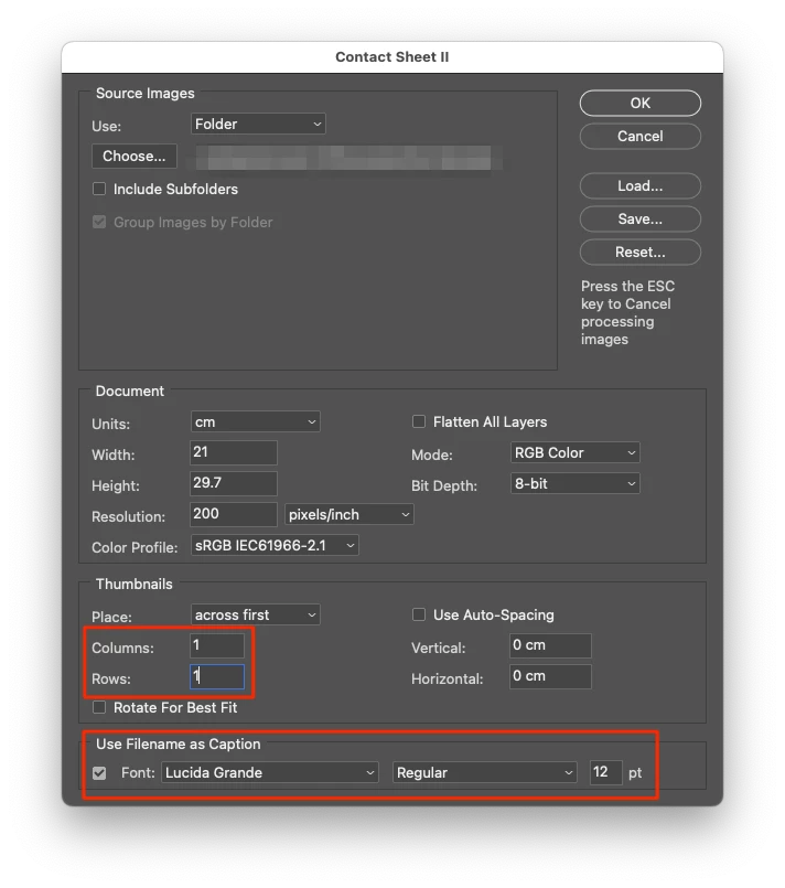

The goal is to place all the individual portraits on one page and automatically add each student's name beneath their photo, utilizing the filenames as the source for the names, all without engaging in complex scripting or coding.
By @Adi1231234
This needs scripting, but it doesn't have to be complex. You can use the built-in Contact Sheet II script:
The "Filename as Caption" will include the filename extension (.jpg or .psd etc). The default script could be altered or you can create an action using find/replace text to remove the extension and then use Batch to run the action over all open contact sheet documents.
P.S. You may also find the following topic of interest:
https://community.adobe.com/t5/photoshop-ecosystem-discussions/automate-contact-sheet-ii-is-there-a-way-to-not-have-the-file-extension-in-the-captions/m-p/14252498
