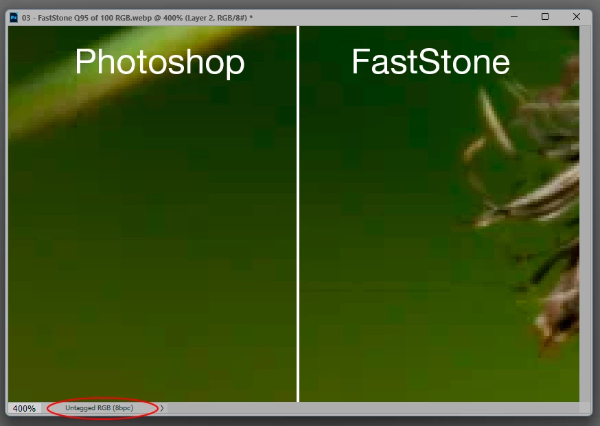

    Aug 25, 2026 3:12 PM UTC
    I don’t see any more banding in the Photoshop version you posted - actually, if anything, it looks smoother. Here’s a detail at 400%, and what you see here is just normal 8 bit banding. There’s only 256 discrete steps per channel in a jpeg, and that’s what you see here:
    However, your images are untagged. That makes it difficult to assess. It could be down to how the two applications handle untagged material. In that case Photoshop will convert from your working space to your monitor profile, but other applications may pass the data straight through without any conversion at all. If your monitor profile is defective/damaged, that may account for the difference.
    Aug 25, 2026 3:18 PM UTC
    Look at the smooth gradients to the left of and above the bird. You don't need to view it at 400% magnification; the banding is visible in the full frame. I use sRGB ONLY.
