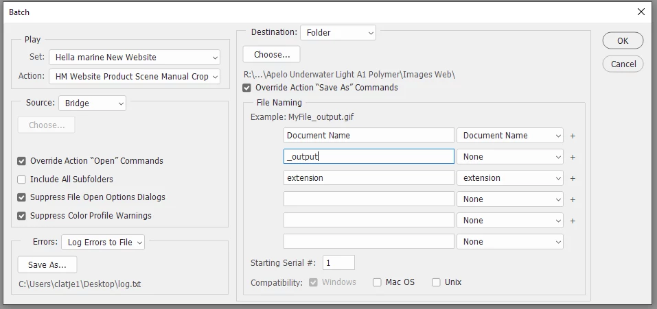

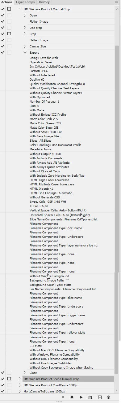

Can anyone offer any advice on fixing the Export location step in the Action I build for interractively batch processing product images? When I run the action as a batch process, it ignores the  'Overide Action "Save As" Command' setting in the Batch panel, and instead insists on using the original Test location that was recorded in the Action (it will error and fail if this Folder  isn't present in the original location).
I don't know if it is relevant, but both the Source folder and the intended Target folders are on Server volumes.

As this is interactive batching you could set the modal control next to the export step and possibly manually override each save. You have done this for the crop step in your action screenshot.

You need to use Save As, not Export for the override to work.
You would need to add extra steps to remove metadata or perform other operations that Export Save for Web performs. Or process the output files as a second pass step.

Unfortunately, this is the wrong tool for the job, batch override doesn't work with export.
A script could batch using your S4W settings.
EDIT: It is risky to work to/from remote volumes, best practice to copy the files and work locally.
