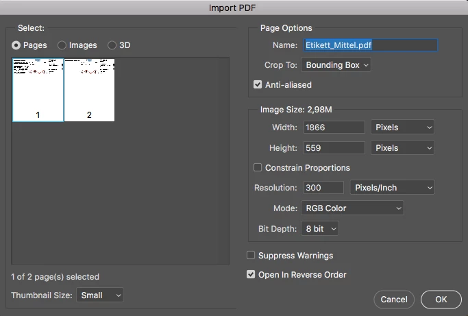

Usually I would just write a short action with save is but the problem is every time I open the pdf file this window pops up:
So when I write the action with saving the files as a jpg and attach the folder with the pdf files for Batch process, this window pops up for each pdf which kind of kills the automation.
What would be the way to do it? Is there a way to write this setting (I need then as Pages) into an action as well? Or what can I do?

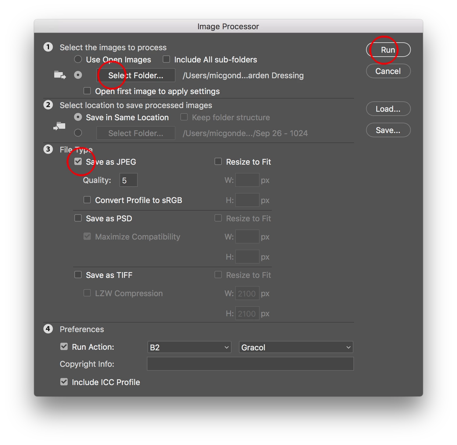

File >> Scripts >> Image processor
This will create a folder named JPEG that will store all the copies of your files in .jpg format.
For mine ai also run an action to convert the color profiel to Gracol, you can choose any action that you have created if needed or to  further automate
If you have trouble with resolution let us know in detail about the pdfs you used and  results you are getting and one of us can assist you further.

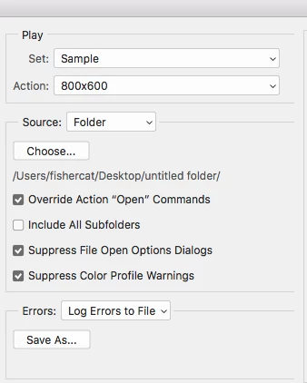

Try checking the Suppress Warnings box when you record the action, so in this case the action is always going to open the selected page 1 along with the other options you have chosen. Then when you batch the action also check the Suppress boxes there:

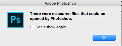

I have just tried to surpress warnings as you suggested, but in this case it just opens all the original pdfs in the distorted form and then gives me the following warning:
and the action does not save anything.
This is how it looks when I open the files one by one:
and this what happens when I run an action which says open, save as a jpg (which does not happen) and close.
