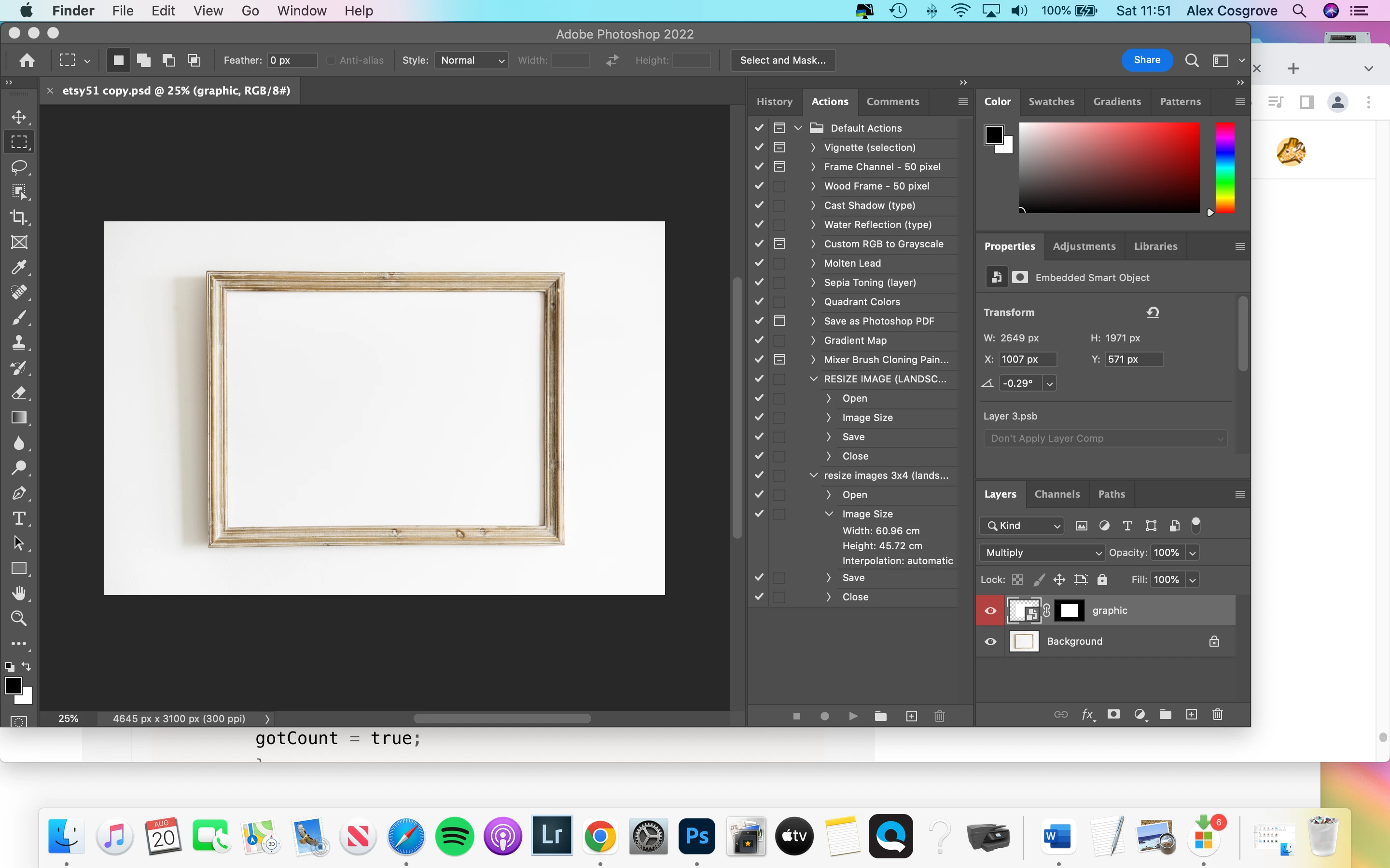

Hi
This is what I have - this is blank mock up file

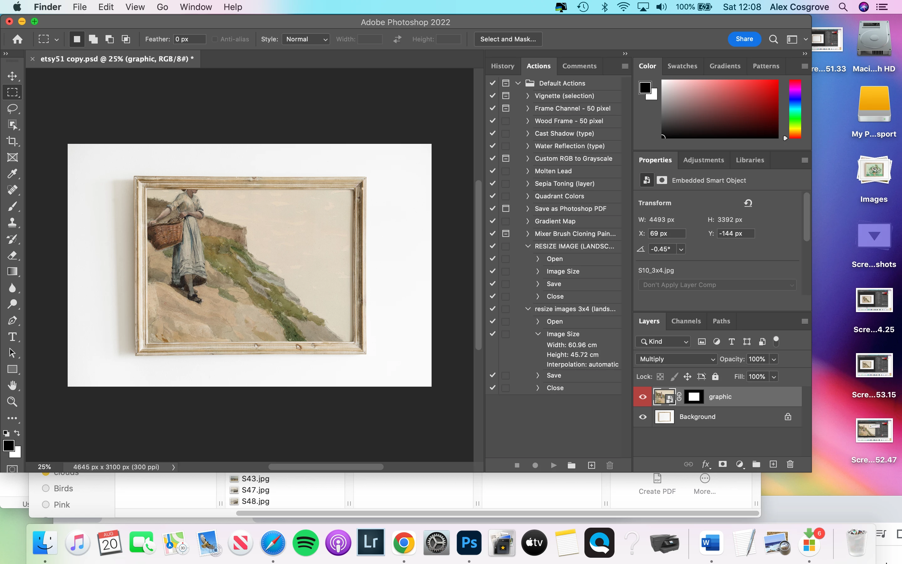

 so when I add the image - I click on the smart object layer and it opens the second window- where I do place embed and then close and save that window and then the image appears in the frame in the correct proportions.
 But when I run the script instead of the image the image is placed directly on smart layer so it fills it and I get this

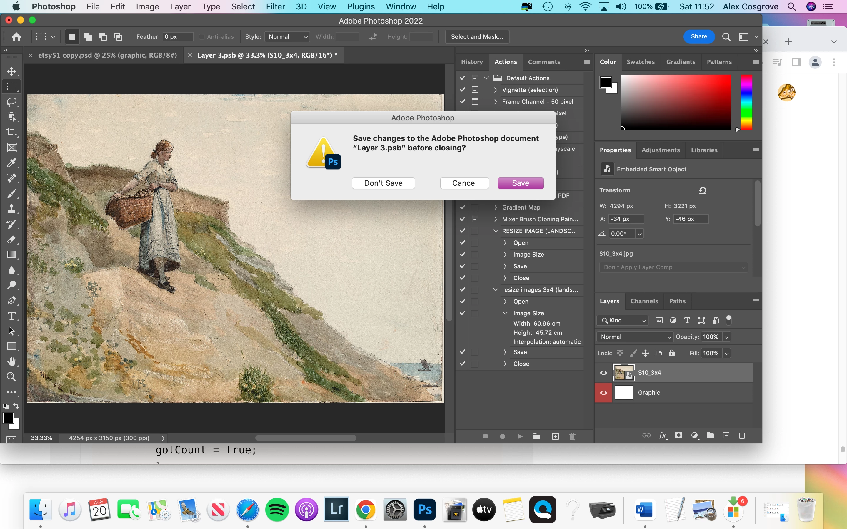

"If you want to replace a Smart Object inside the Smart Object the code needs amending."
Is this what I am trying to do? There is only 1 smart object, but it has a layer mask linked to it? I am not sure I understand. Clearly I don't know what I am doing! I have only just discovered that scripts even exist, so a lot to learn!  I will have a look at those threads you suggested to see if they help but appreciate any help you can give.
c.pfaffenbichler
August 20, 2022
Apparently no, you want to place a SO in the SO.
But why not work from the file you create anyway – the one with the SO inside the SO?
