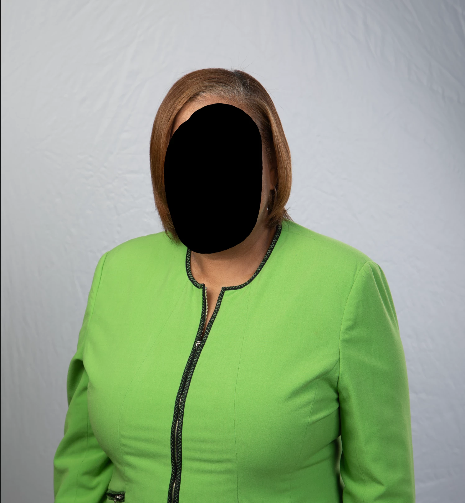

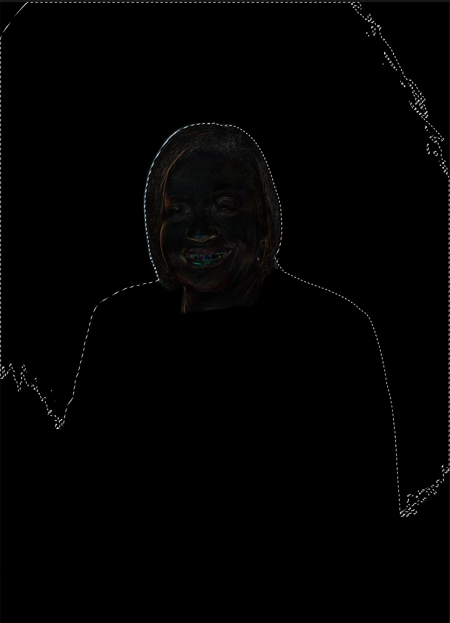

February 14, 2023
Hey Michael,
Thanks for posting this. I can't access the link, so I've tried to walk through the steps and I'm getting stuck on the isolation in step 3. By isloate, you mean select right? When I try to select, it's selecting elements from the original image. I'm not sure how to get it to select just the difference.

Your right. Photoshop doesn't have a dedicated tool or many facial recognition features. The only one I can think of is liquify. I just experimented with the liquify filter using facial aware settings to isolate and bloat the face. I then made a difference mask between the liquify processed image and the original image. A few more steps and I had a selection around the face and then a crop. This could be batched with an action. I was pleasantly surprised with this proof of concept, however it would need more work and testing. Other steps would also be required.
