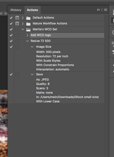

Hello, could you post a screenshot with the action panel (not in button mode) showing the action set and the action?

Here it is, thanks for taking a look. I've tried with and without the save at the end

Message "command [whatever] is not currently available" is displayed when the action attempts to execute a command that is "greyed out" at the moment.
I think that there is no file open on which to apply this command: tha batch command settings and action commands are wrong or in wrong order. Please check the settings and the sequence of commands of the batch and of the action.

June 11, 2018
I didn't know the sequence was important; I will check on this thanks.
