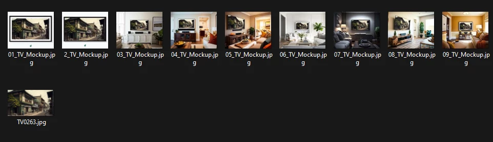

File saving/naming:
All files saved to the new incremented TV#### folder.
The 3840x2160px placeholder image will be named: TV0288.jpg
The x9 2000x1600px images will be named: 01_TV_Mockup.jpg etc.

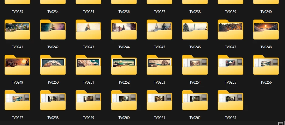

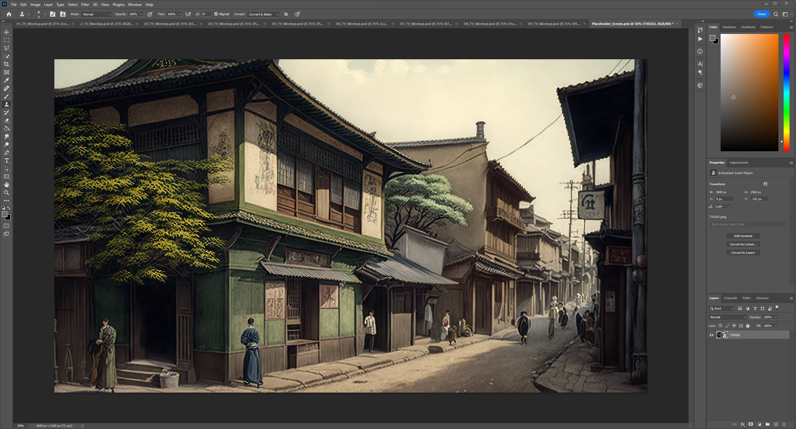

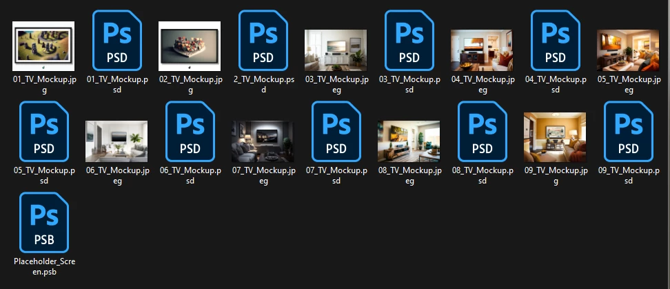

Yes definitely. So here are my template files. Every single one is linked to the .psb smart object file (at the bottom).
I open them up, then place my image into the .psb smart object file and save it which then updates all of the photoshop template files. You can see all my files open at the top.
I would then like to export these files into their respective folder. All my images have a numbered folder.
The final result is all of the photoshop files exported at 2000 x 1600 px with the new image. The .psb smart object file is itself exported at full-scale high quality which is 4k (3840x2160px). I currently do this all manually. Image processor helps but if I could place all my different images in the psb file and it shoots out all of the exports for each different image and its respective mockups into their own folders, that would literally cut my time by like 90%.
