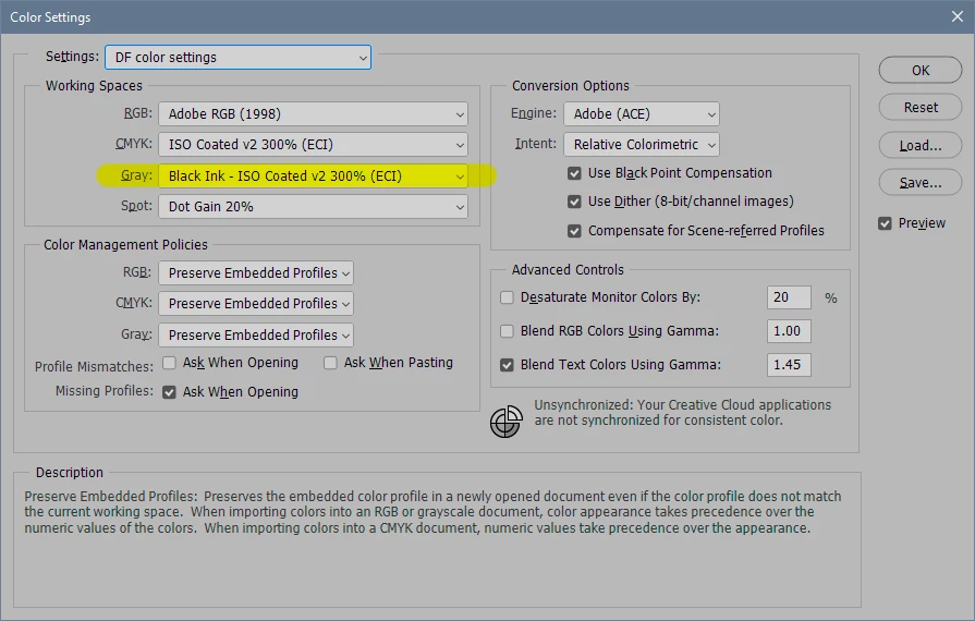

    D Fosse
    June 17, 2019
    Work in CMYK only if you know the actual specific CMYK profile appropriate for the press and paper used. You get this from the printer.
    The Photoshop default just happens to be US Web Coated (SWOP), but that's just because there has to be some default. SWOP is not used in the rest of the world outside the Americas.
    CMYK to CMYK conversions should never happen. This will turn K-only black into 4-color black, among other potential issues. While working in CMYK, watch the ink limit! This varies with profiles, but is typically 280-320%.
    If it's vector you really should be using Illustrator, not Photoshop.
    You can use grayscale, but again, you can't use the Photoshop defaults, and you still need to know the CMYK profile. Then you can set the working gray to Black Ink for that profile.
