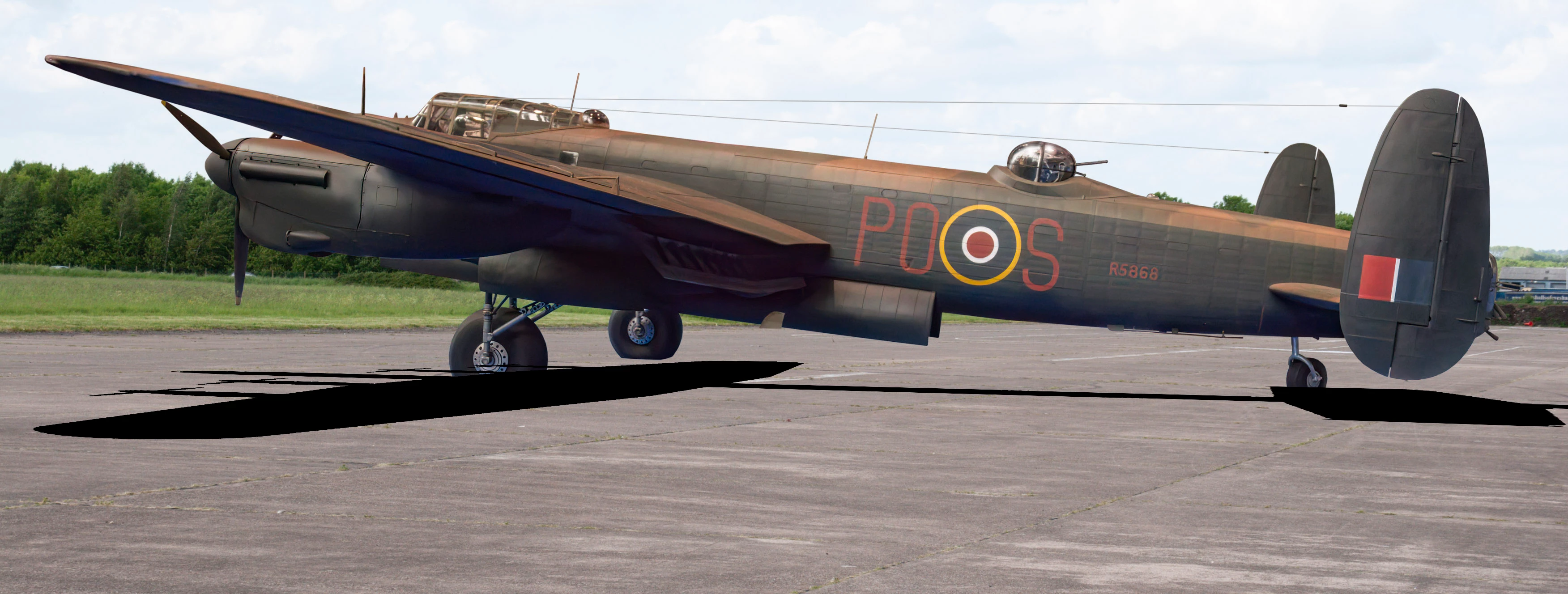

Best method distort plan black silhouette of this aircraft to make its shadow ?
I need to find best way of adding shadows to my 'models into real scene' photos.
I reckon start with the aircrafts plan view as a black silhouette and lay it on the ground.
attached the .psd file for download. It has plan view before my attempt, as well as my best effort.
I am assuming shadow is directly under the aircraft, an overhead light , then I will soften edges and mellow it , being a cloudy day. Wheels then get an extra shadow.
In order to get the shadow, I take the planview, then try to pull it down to the correct shape.
I tried transform>perspective, the most obvious one, but failed.
warp no good, skew no better.
Distort, and its a struggle, the tailplane doesnt want to behave.
Just what is the way as the shadow is the plan view, but on the ground !
Cheers
Merlin

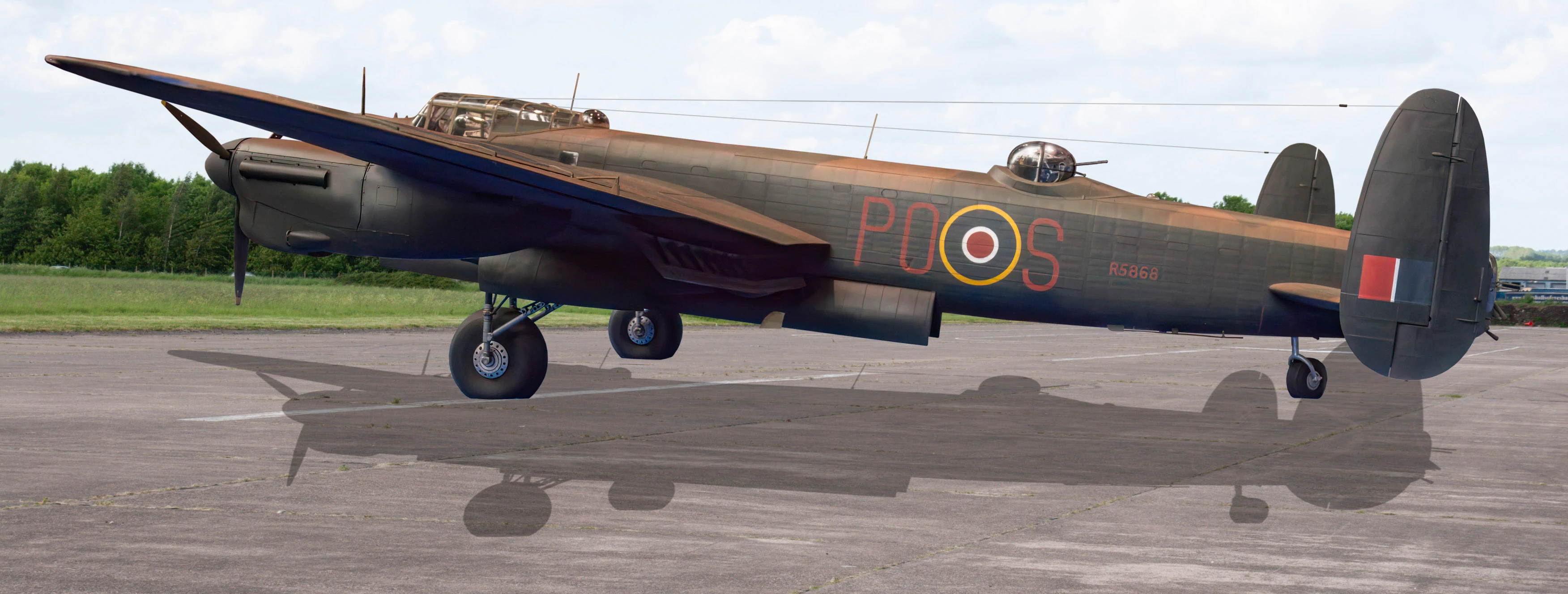

Merlin3Author
Jan 2, 2026 5:35 PM UTC
Hi bct_4763,
I get a feeling you are on my page.
in my first post I attached the .psd file, it has a layer with the shadow on it like a bird thats splatted against a wall !
I see it got cropped, so also attaching it complete this time.
....and also my use of distort on that, which in a single use sees wings behave and tail go beyond where its needed, like two puppies one on a string the other on elastic cord !!!! I need to get the trailing edge of the wing shadow under the aircrafts trailing edge. Its not easy. Something wrong in the principle of using the planview it seems, can someone prove its doable.
Here is that file attached again, not sure if viewers are able to download it, I was able to when visiting first post.
I need to get that tail shadow moved fwd towards the cockpit, to sit under the tailplane, and not so stretched. I was disappointed that the distort tool didnt perform an accurate resizing.
and yes blur is vital.
I am using warp on that tail area, the blue nodes cannot be all used at once, I feel the tool needs to have the ability to activate a node, click it, then another and another, its not easy on the brain.
Perhaps chop the shadow and use scale just on the end area.
Just frustrated distort gave me good wings and went off piste on the tail.
Anyone care to show final result and tools used. ?
or do a video ?
Merlin

barbara_a7746676
Dec 18, 2025 5:39 AM UTC
Depending on how accurate the shadow needs to be you can eyeball it with this method.
Select the layr with the aircraft. In the Layers panel, add a drop shadow. Right-click on the drop shadow in the Layers panel and choose Create Layer. With the drop shadow on a separate layer use the Transform commands to resize the shadow. You can select the shadow and add a layer mask to the shadow layer to fine tune some of the edges.
Merlin3Author
Dec 18, 2025 8:09 PM UTC
doing the drop shadow, I get this.
and no amount of transform tooling will get that to become a planform shadow, thats a shadow as if cast onto a wall.
One wouldnt see the upper turret, or the undercarriage like that, let alone the canopy.
the planview silhouette I had (see my .psd file I had attached)  is the basis of a shadow, as light falling down onto an aircraft will make a planform shadow. I needed to make it perspective to get stbd wing smaller, but perspective tool doesnt do as expected.
It has to be the planview of an aircraft modified to get its shadow.
The 3D model is flying, so the shadow isnt appropriate at rear end of the a/c. Also whoever drew that needs to go back to school as its nothing like the Lanc. just look at the spinners,m the upper turret fairing, OMG.
It must be the plan view I have, just a question of why wont it distort to the right shape, the tailplane area is fwd of where it should be, (in fact the 3D one has the same issue), a second use of distort on the result brings it more to where it should be. Perhaps distort needs a few uses, one being beyond its scope ?
Merlin
Merlin3Author
Dec 31, 2025 2:51 PM UTC
Anyone please best way distort a planview of aircraft to be shadow on floor ?
Surely Photoshop can manage such ?
I have gone for monthly subs Pshop from CS6 for basic tools to achieve such things , and find it still lacks even a brush that retains width of soft edge as brush size changes for tracing round objects going into sharper narrow detail. Esssential for correct object transfer and editing. The transform tools are not very user friendly at times.
matching the texture, dpi and colour of a recipient photo, not easy, harmonizing the hue and tint of a set of panorama pics, basic photo needs.
So surely a plan view of this a/c (as in the attached .psd in prior post) can be laid out to sit under this a/c. I cant get the tailplane area to behave.
Cheers
Merlin

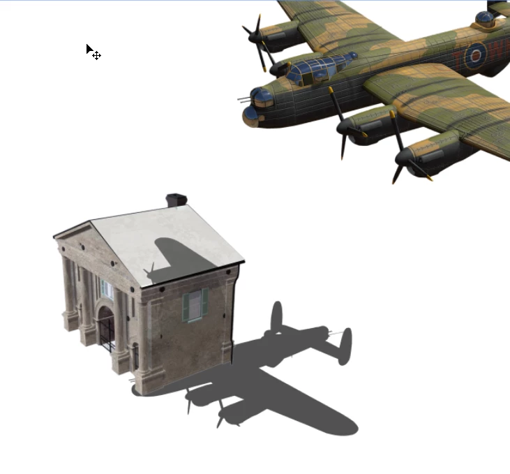

Trevor.Dennis
Dec 18, 2025 12:52 AM UTC
I use sketchfab to find 3d models.  It has a truly massive number of items that you can rotate on all axis, and then screen grab to get the angle you need.
This one has an attached shadow.
https://sketchfab.com/3d-models/avro-lancaster-2f15889043d84b09835aea5fa47ac0af
This one doesn't, so you can orientate with the mouse. Remove background, apply the l;ayer mask and fill with black.
https://sketchfab.com/3d-models/avro-lancaster-d12038b69a3541ecb33e3e8efcafff0f
I generally use at least two layers to create shadows, and more if the shadow falls on multiple planes (surfaces at different angles) so be prepared to cut the shadow into sections.
Other than that, every case is different.  You need to work out the angles and decide what should fall where and how it will be distorted.  If you have a specific exaple to share, people here might give specific help.
