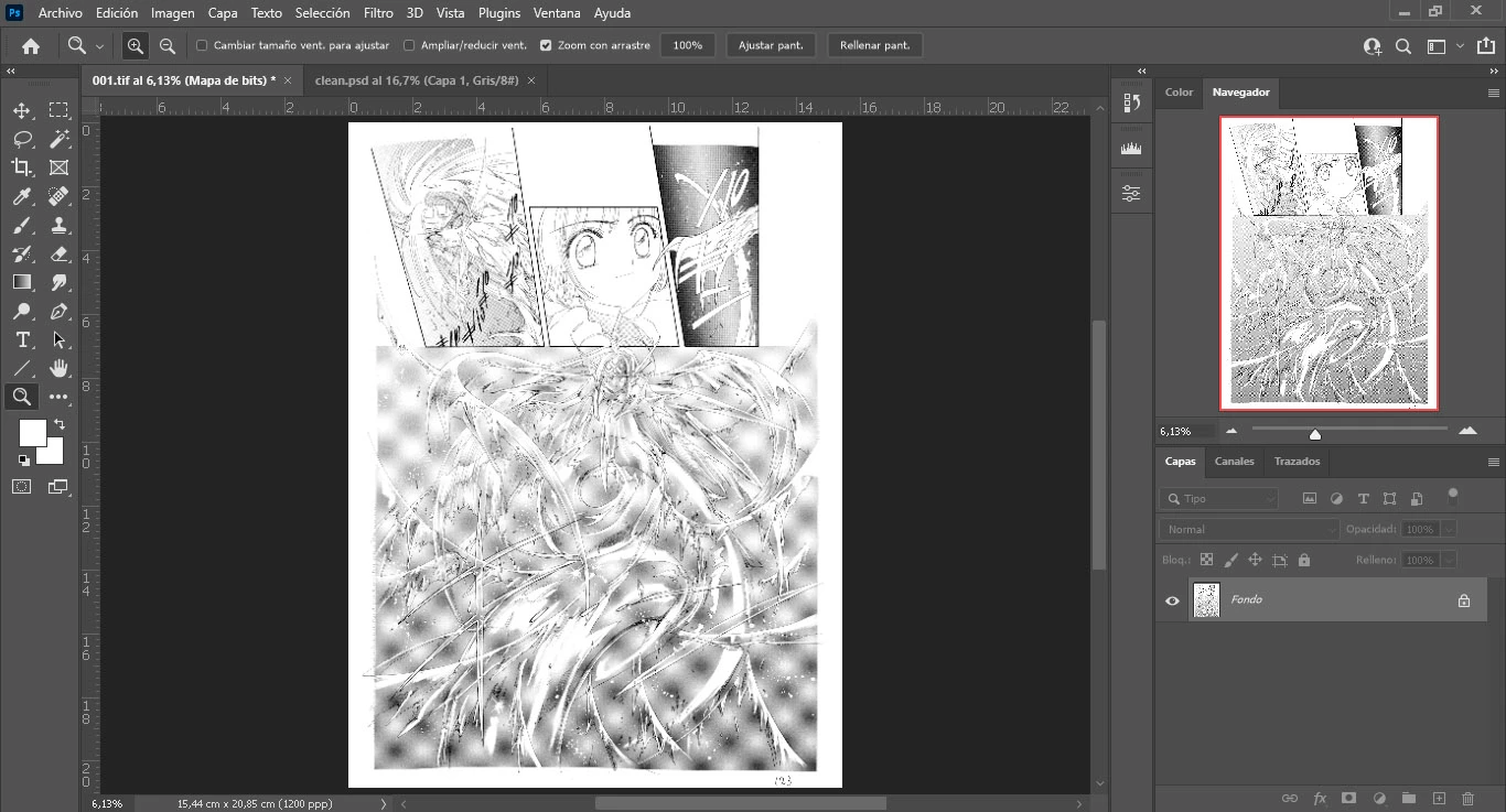

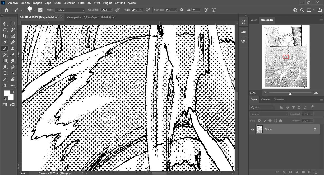

September 11, 2021
Hi, thanks everyone for replying.
Here is a screenshot.
So what was I tying to do was select a panel of the manga, edit it in a new file in grayscale, and then paste it back to the original in bitmap, but as you said I can't paste and neither use layers.
Should I convert a copy of the original file to grayscale, edit it, and then againg to bitmap? Or is that going to affect the quality badly? The instructions clarify not to convert to grayscale but I'm unable to find another solution.
