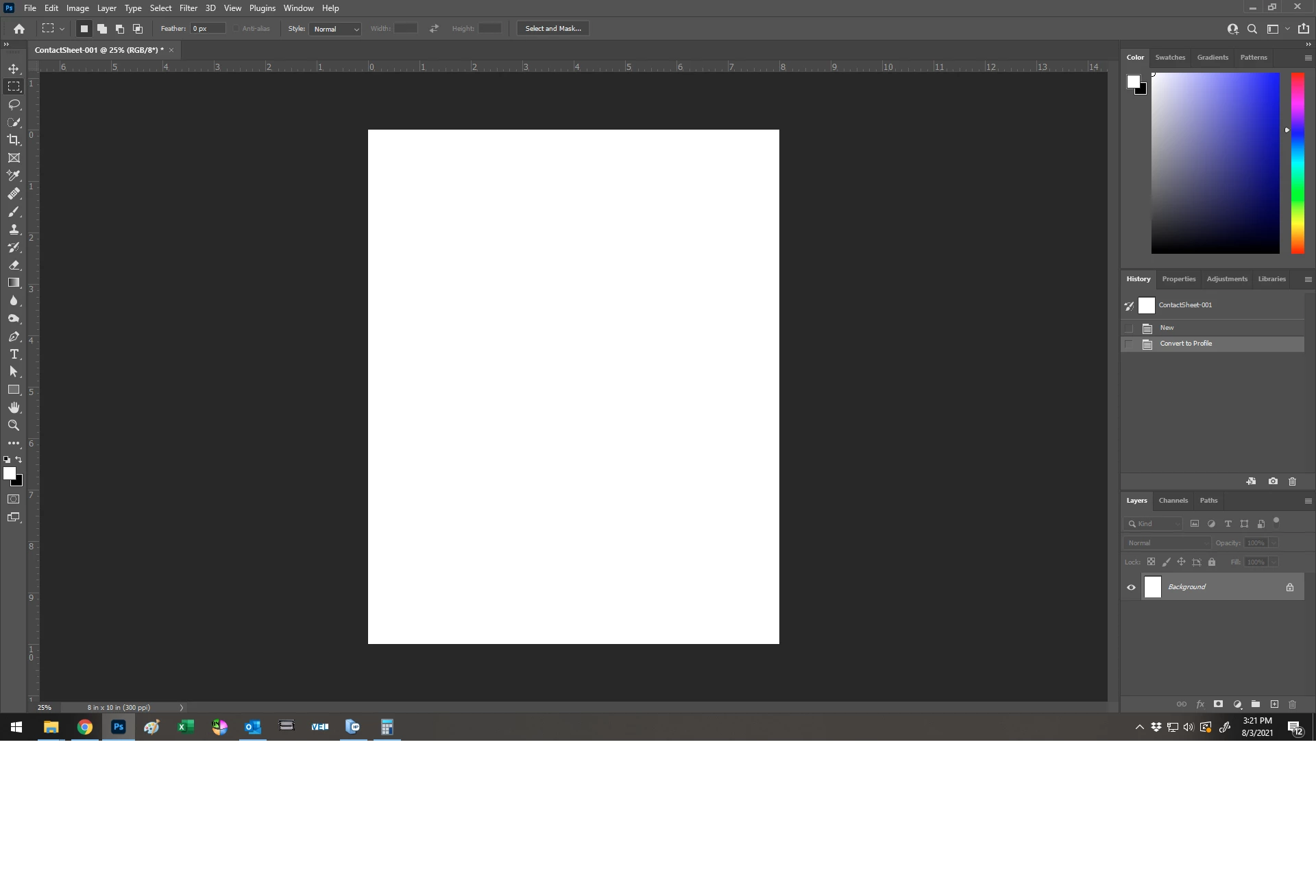

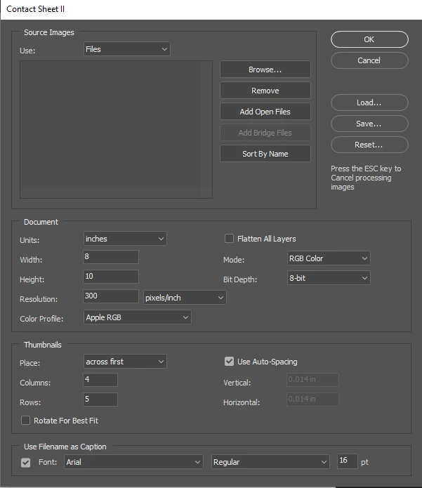

Hi all,
I've scoured the internet for a solution to my problem with Contact Sheet II to no avail.
Everytime I try to generate a Contact Sheet in Photoshop it comes out blank. Nothing shows up, no layers or text is created. I tried adjusting everything in the settings I could; changing the color profile to every different one, I tried CMYK. Checked and unchecked almost every setting I could.
Nothing has changed. I even uninstalled and reinstalled Photoshop.
I'm on a Windows 10 computer with everything needed for Photoshop to run updated: version 22.4.3 Photoshop.
Any help is appreciated. I use the Contact Sheet generator for work and would love to get this fixed ASAP.

Update 2.....
I think it's the way I named my files.
I just dumped all my PNG files into it trying to pinpoint why only some would work.
The files that wouldn't work were named "100% Rayon....". All my other files would load and get generated into a Contact Sheet.
I do believe this might be what is happening.
I'm going to leave this up in case anyone has the same issue. Since I couldn't find anyone else with the same issue on the forum.
