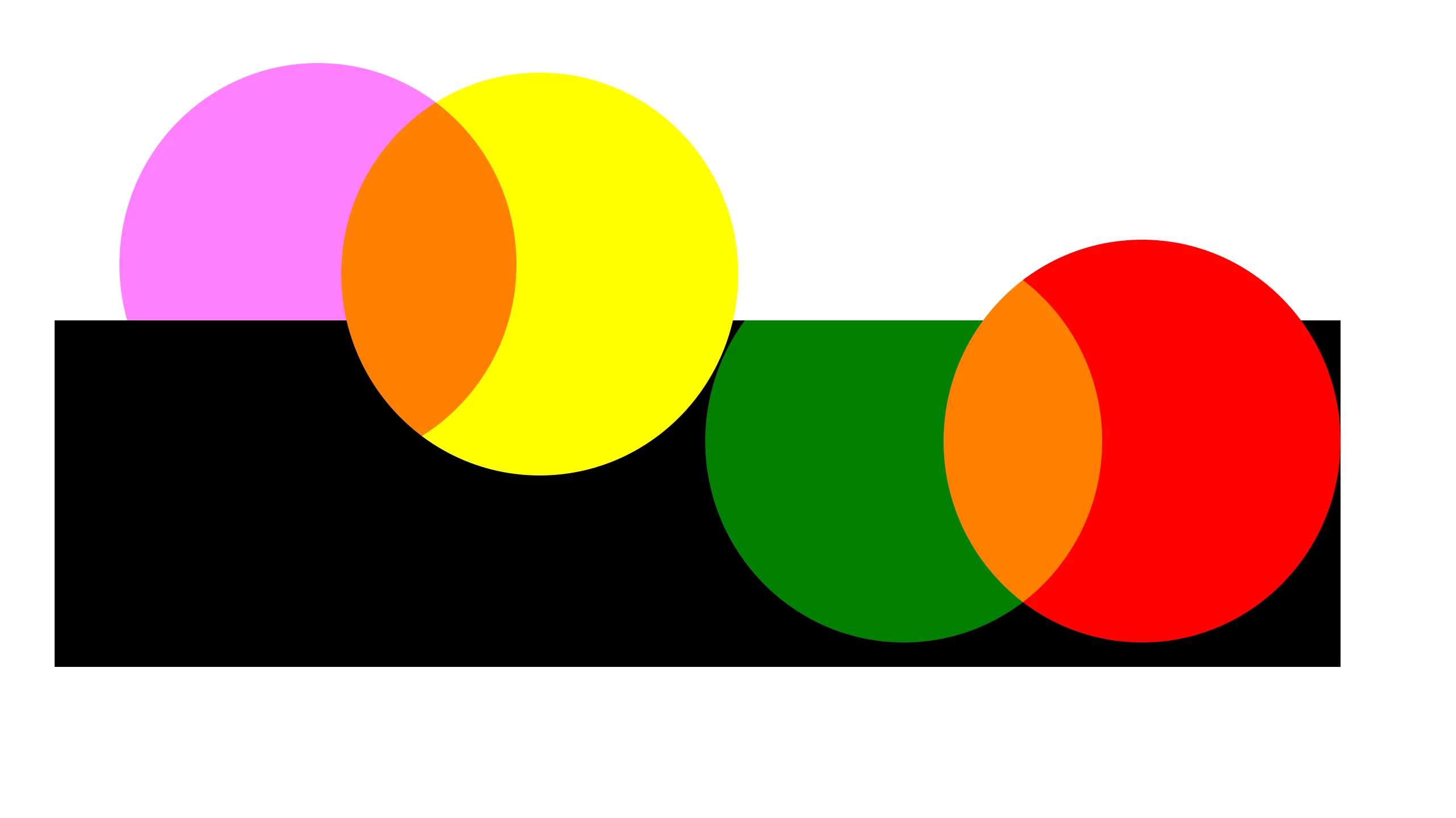

Chuck Uebele
April 13, 2024
Mixing paint is far different than mixing colors in PS, As mentioned, RGB is additive, while CMY is subtractive. With mixing paint, you are diluting each color with the other color. To get orange with additive RGB, you need to use Red and Green, with green at 50% opacity and with screen mode. Using the subtractive method, you need Yellow and Magenta, with Magenta at 50% on multiply mode.

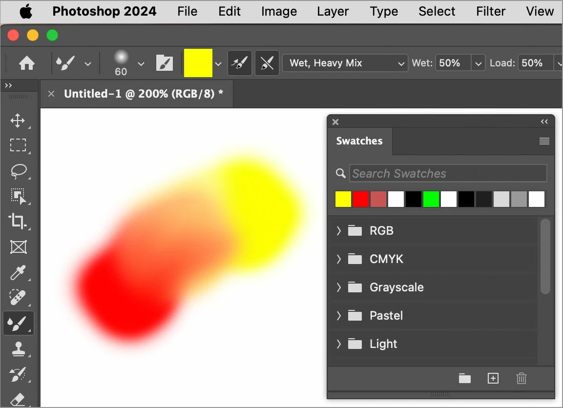

April 13, 2024
Well, it depends…if someone uses Photoshop for digital painting, the Mixer Brush tool in Wet mode does mix red and yellow into orange, probably because the Mixer Brush tool is supposed to emulate how subtractive paint works. So that can exist in an RGB document where other layers are composited using different color mixing models.

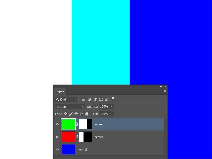

D Fosse
April 12, 2024
Screen blend mode. That adds the numbers.
