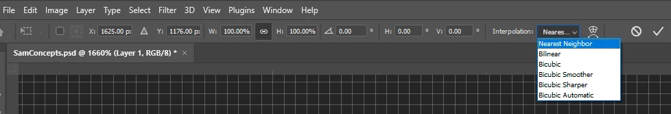

When I am resizing an image, there is a preview render of the image prior to verifying the resize. I am currently using photoshop for the purpose of small scale textures (16x16, 32x32, 8x8 pixels). However, every time I finish/confirm my resizing Photoshop retouches the image and makes it useless to me. I would much prefer the uneditted/unaliased image from the preview. How can I do this?

Hi default,
When you are using your transform option (Ctrl + T) try changing your interpolation to "nearest neighbor" in the toolbar.
Chris 486
Chris 486Community ExpertCorrect answer
July 11, 2022
Hi default,
July 15, 2022
Hi Chris, thank you for your response.
I did this and rescaled my image to find that it preserved most if not all of the details I needed for my image. Thank you!

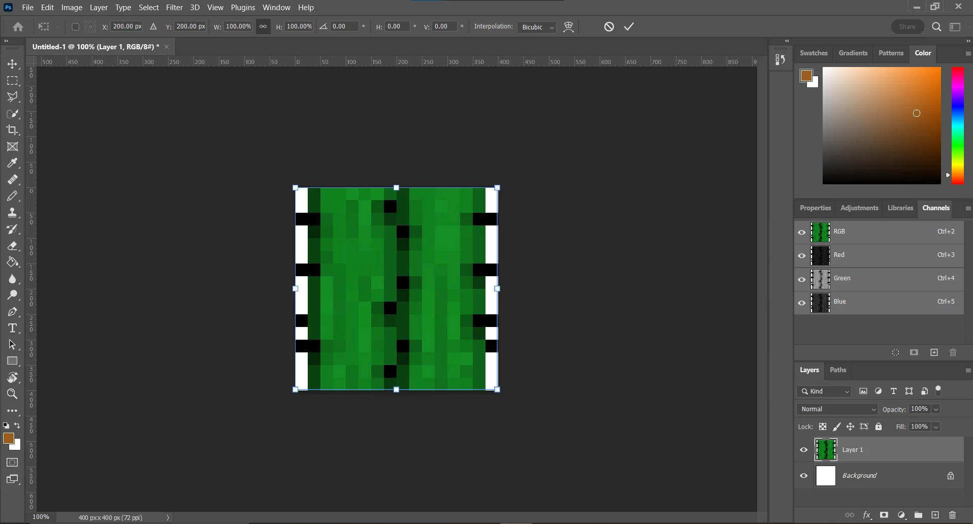

c.pfaffenbichler
July 10, 2022
Your terminology seems problematic, Photoshop does not »retouch« the images, it resamples them with the method you either chose or never changed from the default settings …
Could you please post screenshots taken at View > 100% with the pertinent Panels (Toolbar, Layers, Channels, Options Bar, …) visible?
What is the Resample Method you apply (Photoshop > Preferences > General > Image Interpolation)?
Which ones have you tested yet?
July 15, 2022
Hi, thank you for your response.
Please excuse my poor use of language and terminology, I am not familiar with photo-editting and english is not my first language. I also apologize for my response time, I was off at work and was not able to view your response.
I haven't found time to adjust any settings or preferences within Phtotoshop, so I was using the default resampling interpolation, Bicubic.
As stated previously, I haven't changed any setitings so I have only used bicubic (which yielded the results causing my issues). What should I change to adjust the resampling to result in a sharper/more detailed image?
