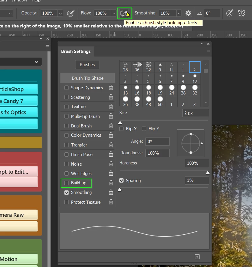

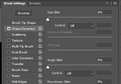

For me, the Airbrush icon is NOT enabled and “Build-up” is unchecked in the Brush Settings.  I need to make clear that the problem I was experiencing with unintended build-up occurring was directly related to first using a UXP plugin to set brush Opacity or brush Fill.  Using a UXP plugin to adjust either of these causes build-up to subsequently occur even though “Build-up” is unchecked and the Airbrush icon is NOT enabled IF “Shape Dynamics” is checked in the Brush Settings.  By unchecking “Shape Dynamics” this problem no longer occurrs when I used the UXP plugin to adjust brush Opacity or Fill.  I’m going to try and make a UXP plugin that isolates this issue to a single button.  Not sure if this will work, but it might give Adobe something work from to correct this problem.
Oct 1, 2026 3:54 PM UTC
Correction:  It’s setting “Control:” in the “Shape Dynamics” setting to “Off” that fixes the problem, not simply unchecking “Shape Dynamics”.
Oct 1, 2026 3:51 AM UTC
More clarity.  The problem is that the paint build-up still happens when an UXP plugin selects the brush tool and changes a brush parameter, such as Opacity or Flow.  If the user selects these from the Brush Options Bar, paint build up does not occur with the stylus.    However, I think I solved this issue.  In Shape Dynamics in the Brush Settings, I set the drop-down menu to “Off”.  That seems to be working for now, but I will do some more testing and see if this fix continues to work.

Hi Anthony
Your screen shot doesn’t quite extend to relevant setting.
If the Airbrush icon is active in the Options bar, then Build-up will become enabled in Brush Settings, and vice versa.  Or are you saying that this setting becomes active even when not part of a particular preset’s setting?  I am not sure how you could know that.  If you select a preset and Build-up becomes enabled, then surely it part of that preset.

Oct 1, 2026 3:28 AM UTC
DisableTabletRepeatingPaintMarks 1
is no longer listed on this page:  https://helpx.adobe.com/photoshop/kb/enable-optional-extensions-photoshop-cc.html
Is there any way to fix this issue of paint build-up when using a stylus?
