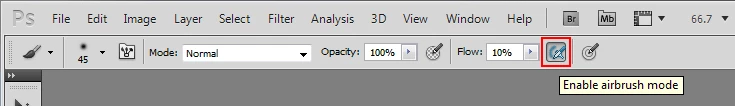

For whatever reason the hotkeys for controling brush opacity and flow switch randomly, and its a bit frustrtating in my work flow.
For the hotkey for Opacity will atlernate between 0-9 and shift + 0-9
The hokey for Flow will alternate between 0-9 and shift + 0-9 as well
One project I will be used to useing shift + 0-9 to adjust the flow, but in the next document it will alter opacity instead.
Anyone know what may be causing this?
    Correct answer Jeff Arola
    Check to see if the airbrush mode is enabled in the tool options bar when the shortcuts switch.
    Having the airbrush mode enabled will cause the opacity and flow shortcuts to switch.

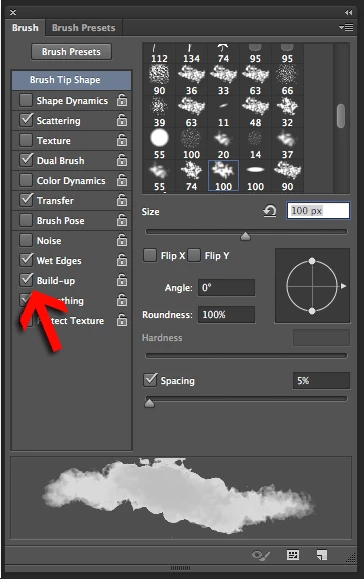

    To add to the previous post: if you are using a custom brush that has "Build Up" turned on in the Brush panel, this will also enable Airbrush Mode and switch the # and Shift+# keyboard shortcuts.  Hope this helps!
