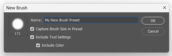

If you give it setting is the Brush Settings panel and use New Brush Preset from the Hamberger menu to right corner, then you have the following options.  I can see a situation where moving between preset might possibly do what you are describing if the new preset was NOT saved with those options checked.  That would be why some retain old settings and some don't.
For brushes other people made and I installed, it is evident that the first two checkmarks were checked (size and tool) but not color. For brushes I made, I either checked on the tool one or none of them. But the settings I was having problems with were not size, tool, or color, but other stuff that is saved with all brush presets that are created in the Brush Settings panel.

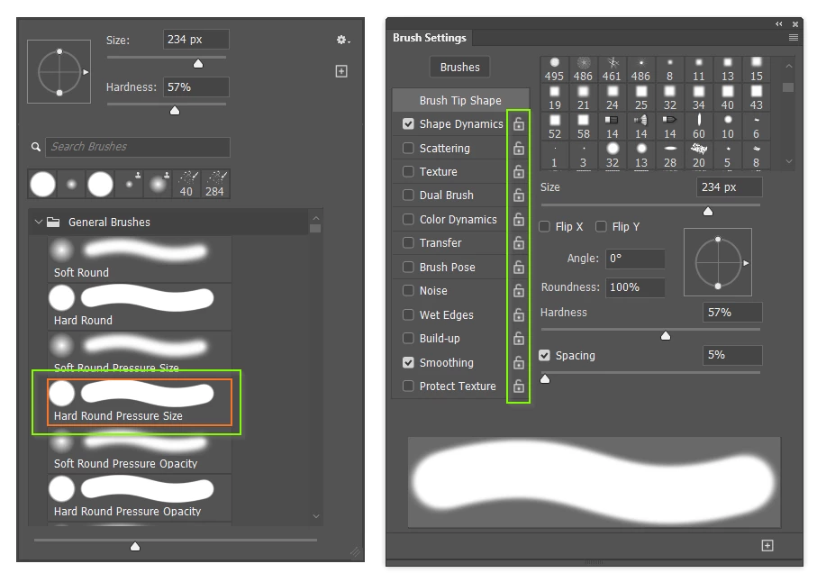

What you could also check, is if any of the settings have been locked as per the Screenshot below.  My guess is that is not what is going on because it would apply to all subsequent presets you select until the lock icons were clicked to turn off.
This was exactly what was happening, as I stated in my previous post. Yes, it apparently applied to all subsequent presets, but since not ALL of them were locked and I was manually "fixing" the settings, the consistency was less obvious. About 3 or 4 of them were locked, and once I unlocked them with the flyout menu option "Reset All Locked Settings", the problem went away.

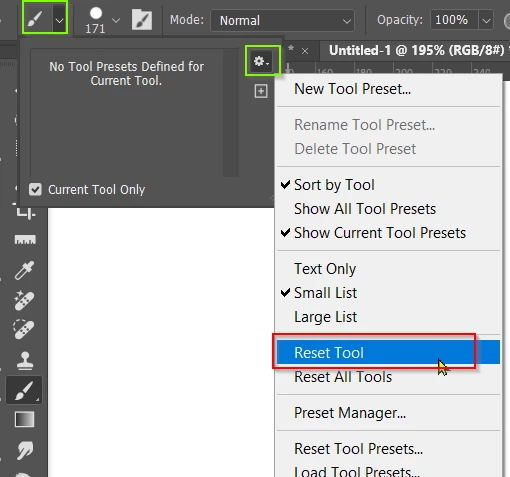

Most tools can be reset from the top left corner of the workspace.  However, it's a bit like resetting Preferences. You fix it by going back to defaults, but you missed the chance to work out what was going on and learning something.  The first place to check with most tools is the Options Bar.  It might be the brush blend mode, for instance.  If you have a good look round and can't see a problem, _then_ go ahead and Reset.

When saving your brushes, create or modify a brush and want those specific settings (including size, scattering, texture, color dynamics, etc.) to stick to that brush whenever you select it, you must explicitly save it as a new brush preset. Go to the Brushes Panel (Window > Brushes). Click the "New Brush Preset" icon (a square with a plus sign) at the bottom of the panel, or go to the panel's fly-out menu (four horizontal lines at the top right) and choose "New Brush Preset." In the dialog box, crucially, make sure "Include Tool Settings" is checked. This ensures that things like foreground and background color, blending mode, opacity, and flow are saved with the preset, if desired. For the other dynamic settings, they are inherently saved when you create a new brush from the Brush Settings Panel. Give it a clear name.

Aside: You mentioned "Include Tool Settings", but most of the time I don't want todo that with my custom brushes - sometimes I want to be able to use the same brush to paint and erase, and that's impossible if I include the tool settings. I also wouldn't want the colors saved, although that doesn't appear to be happening with any brushes anyway - all the after-market brushes I have installed have the tool icon and won't let me use them with any other tool, so I think they were all saves with "Include Tool Settings", but none of them force particular colors. And blending mode is a function of the layer, not the brush, right? I don't see how a brush preset could dictate that.
