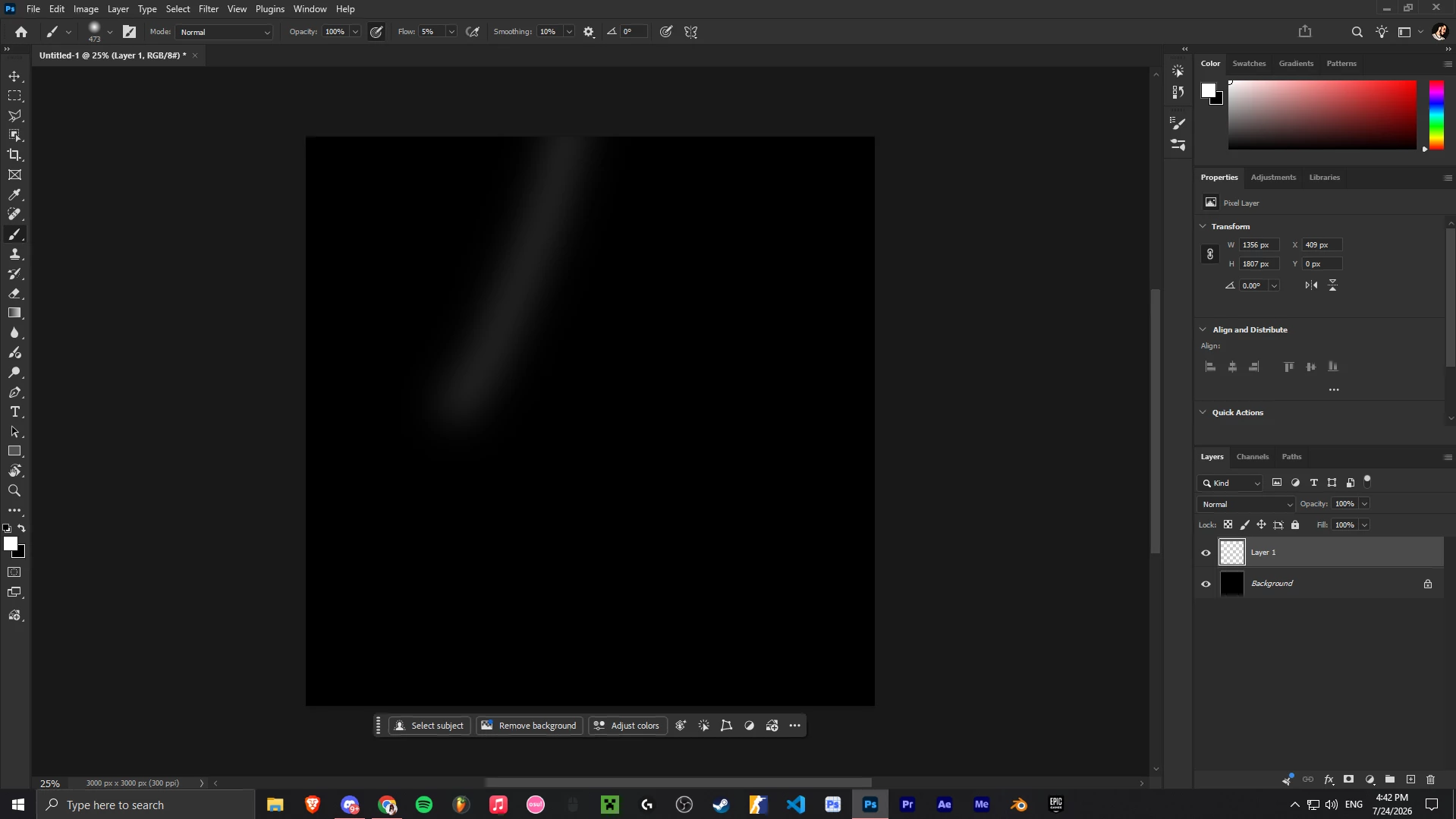

So ive been having this issue for the past 3 months with the Brush Tool ( Flow ) that isnt working properly.

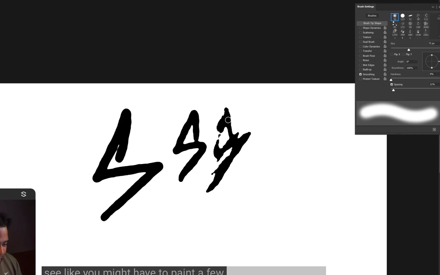

This is how it should work like everybody knows.. the scattering isnt there. I have a video example to show whats going on with my brush tool, instead of doing what it supposed to do, it lowers the opacity.. which is kinda weird..
 here is my video of the bug

    Jul 24, 2026 4:46 PM UTC
    dude its not about that , look at the video again and look at the flow

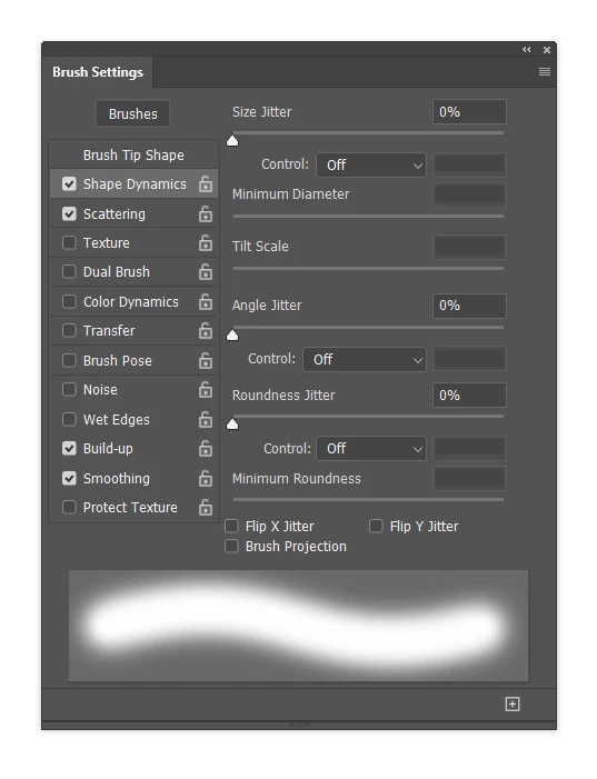

    anyway? What scattering?
    What is the new link to the tutorial »How To Add REALISTIC Highlights in Photoshop!« supposed to illustrate exactly?
    Will you please post meaningful screenshots that include the Brush Settings Panel?

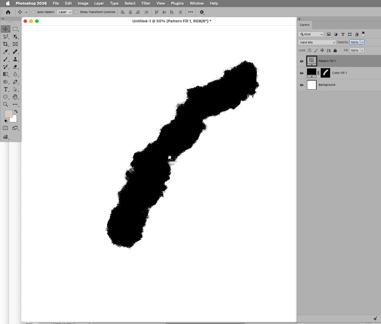

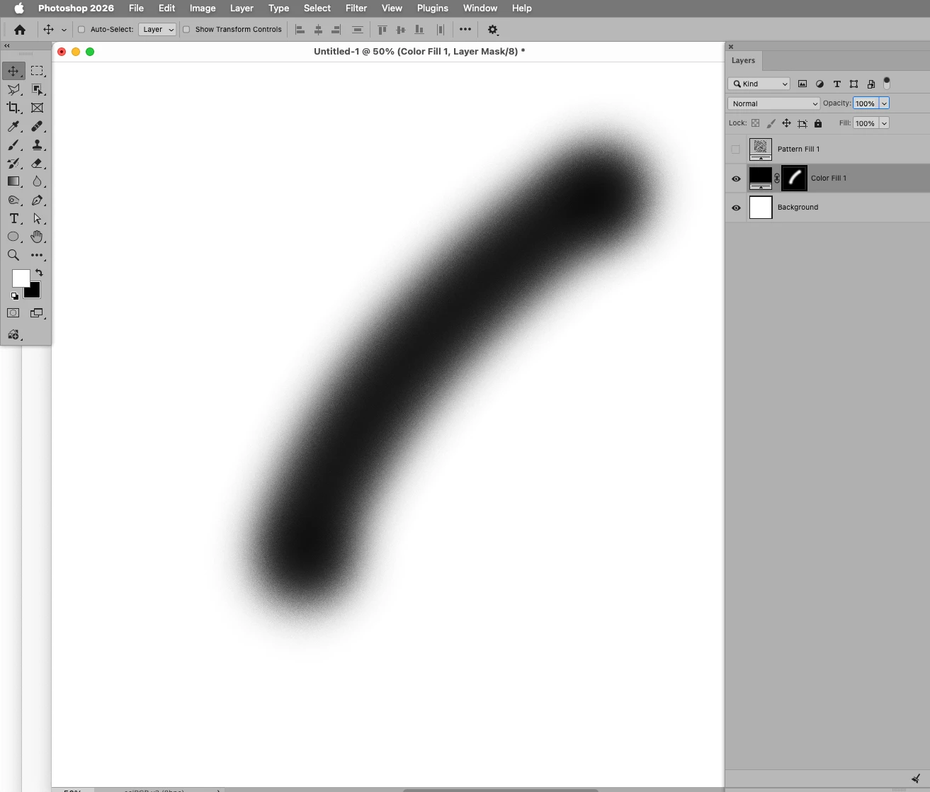

    You seem to be missing the Cloud-Hard Mix-Layer from the demo-video so I am not quite sure what it is supposed to demonstrate.

    like i mentioned, the scattering isnt working how its supposed to work .. instead it lowers the opacity of the brush .. ( FLOW ) lowers the opacity of the brush instead

    What scattering would you be talking about?
    In the demo video no scattering is applied to the Brush but the randomising effect is naturally the consequence of the Hard Mix-Layer.
    If you want to scatter the Brush you should, as ​@Trevor.Dennis mentioned, please post screenshots of the pertinent sections of the Brush Settings Panel.

    Thanks for the video.  Can you show us your brush settings panel.  We’ll probably need to see it with different sections selected and open.

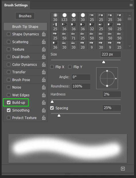

    Is Build Up checked?
    ShindexzAuthor
    Jul 24, 2026 1:53 PM UTC
    I just checked it but its still the same almost

    That doesn’t help unfortunately.  We need to see the Brush Settings panel
    We also need to see the layers panel with the relevant layer selected.
    The brush needs to be selected along with the problem preset.
    Without this information, I don’t see how anyone can help you.
