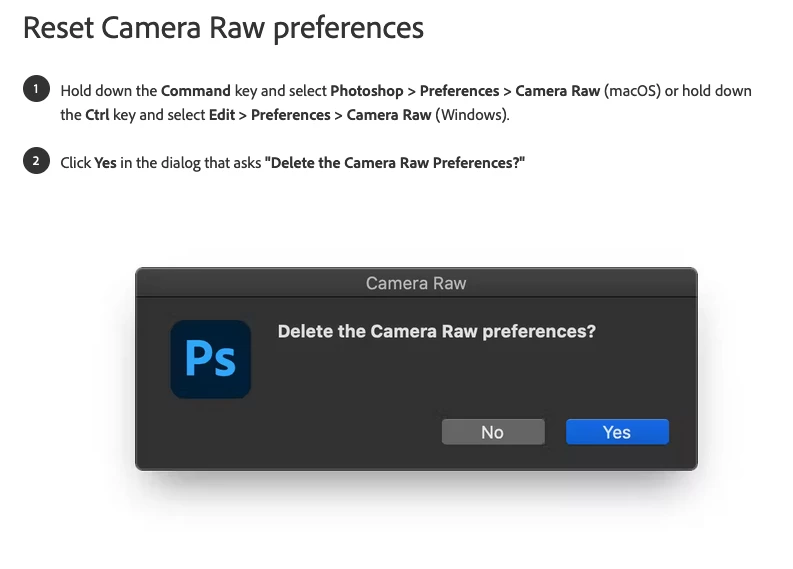

Are the camera raw files on an external drive?
See if resetting the Camera Raw preferences makes any difference.
