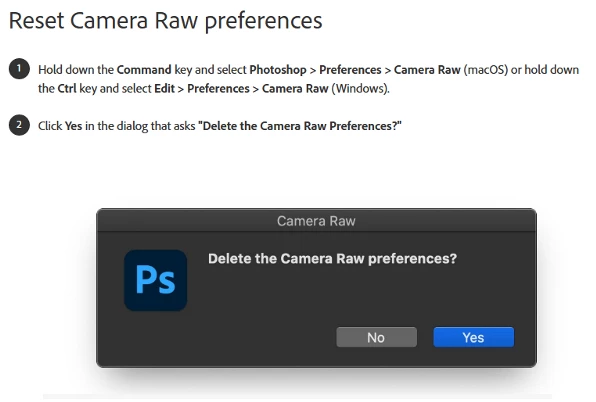

    In a first step try to reset the ACR preferences.
    If this doesn’t help try the following steps:
    Locate the Camera Raw GPU Config.txt file.
    • (macOS) /Users/[user name]/Library/Application Support/Adobe/CameraRaw/GPU/Adobe Photoshop Lightroom Classic/Camera Raw GPU Config.txt
    • (Windows) \Users\[user name]\AppData\Roaming\Adobe\CameraRaw\GPU\Adobe Photoshop Lightroom Classic\Camera Raw GPU Config.txt
    Manually delete the Camera Raw GPU Config.txt file.

    seer5E81Author
    Mar 16, 2026 7:42 AM UTC
    I use this way delete gpu config file and delete preference but not work at all 😭
