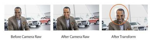

Although this was answered a few years back, I never saw the response. And since then it's been removed! So...
After you do a scale transformation of a Smart Object with an applied Camera Raw filter, the applied Camera Raw edits don't scale with the image. They are still applied, but not in the same area that the edits were applied. For example: I do a Camera Raw edit of a smart layer that is of a face. and use the brush to lighten up the face, and then apply the Camera Raw. I then scale the layer that has the smart object of the person, and the camera raw edit. The scaled version has the Camera Raw edit, but it's no longer isolated to the face.

If you chnge the size of a Smart Object layer with  transform.  Because the  RAW Smart Filter setting  are for a diffent size image your best option is to delete the current RAW Smart Filters and then add a new RAW Smart Filter for the current size image  There is also an additional probem if there is a Filter Mask that is not all White.  It too will be wrong for the changed image size.  Smart Object can not have linked mask the Filter Mask will need to be re-worked for the changed layer size image.
