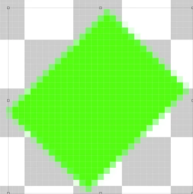

I don't usually do much more than basic techniques so I'm having trouble figuring this out. As in the title, I'm trying to figure out a way to make the rectangle below have clean edges. I've tried a multitude of techniques such as select/feathering and masks etc. I know I'm missing something but I'm not even sure it can be done. I've also watched YT videos but none are specifically for a 45-degree edge but I'm not sure that would even matter either. Can this be done?

    Two aspects should be taken into account:
    For simplicity I'm referring to the illustration. The path hits some pixels. These should  be rendered
    neither red nor green but with something between.
    Let the red area of such a pixel (divided by the path into parts) be (a), and the green area be (1-a),
    with (a) in the range 0...1 . This pixel can have only one color – an interpolated color C = a*R + (1-a)*G.
    If the background were transparent instead of colored (green), then the second term would be missing.
    This says: anti aliasing should be executed with respect to an already defined background.
    The interpolation is linear. But image data in 8 or 16 bits-per-channel spaces are gamma encoded.
    The interpolation would be non-physical. The underlying CIE-1931 color model is strictly linear by
    definition, which is correct under certain test conditions. In order to solve this problem (an unnecessary
    nonlinearity), Adobe had introduced the mode Color Settings > Blend RGB colors with Gamma=1,
    which happened some time after furious discussions in the forum. This mode had been applied in
    the illustration.
    Normally the effect is obvious for interpolations between red and green, or magenta and green,
    where the interpolation path 'crosses' the color space almost diametral. For 'normal' images instead
    of artificial constructs the benefit of Blend with Gamma=1 isn't important.
    For special test images the choice of Gamma=1.6 (instead of 1.0 or 2.2) delivers better results.
    Best regards  --Gernot Hoffmann
    Edited: bits-per-channel

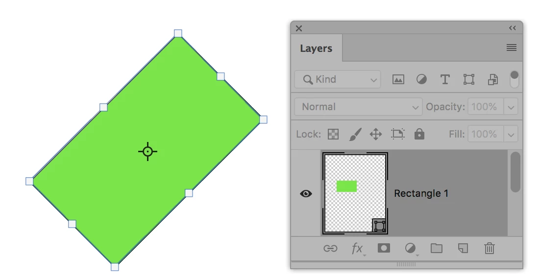

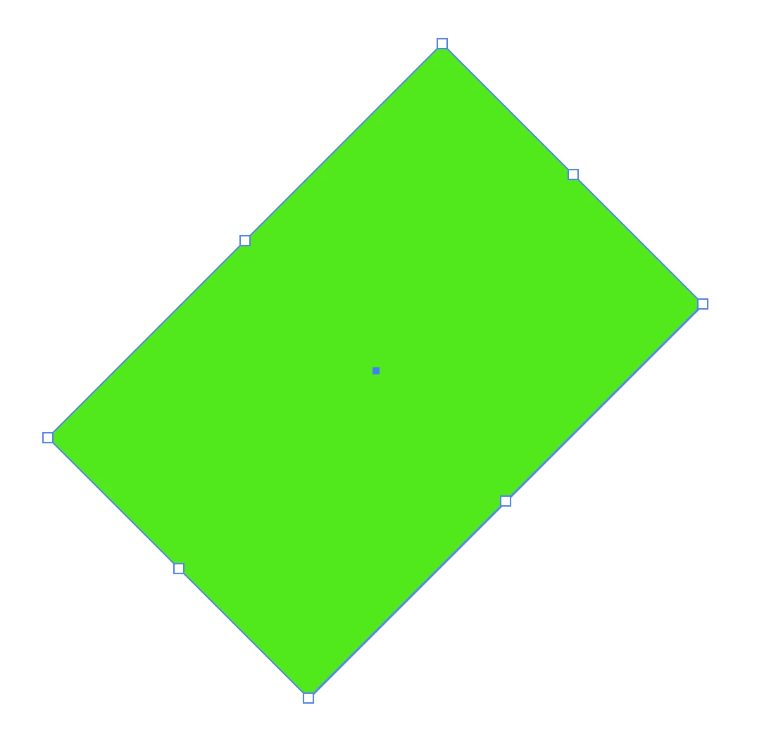

    If you want clean edges, it has to be vector, not raster. This is from Illustrator.
    And this is from Photoshop with the Rectangle vector shape tool.
    Jane

    davescm  wrote
    Thanks, Dave, I just found another reason to stick with Illustrator for vector!
