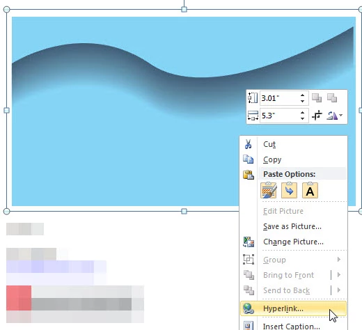

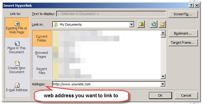

Outlook for PC has this ability.  Are you constructing your email in Outlook using HTML (Not plain or rich text)?  I don't believe it is possible to truly embed HTML into your photo file with Photoshop (or any photo editing software), that functionality requires something else to handle the code, like Dreamweaver to hyperlink to the image on a website, or an email client (like Outlook - at least for PC) to hyperlink to the image to get the behavior you want.
Here's a couple of screenshots, it might help you navigate to the right place with your version of Outlook.
Insert the image then Ctrl-Click (Right click with PC) on the image.
I hope this helps.
