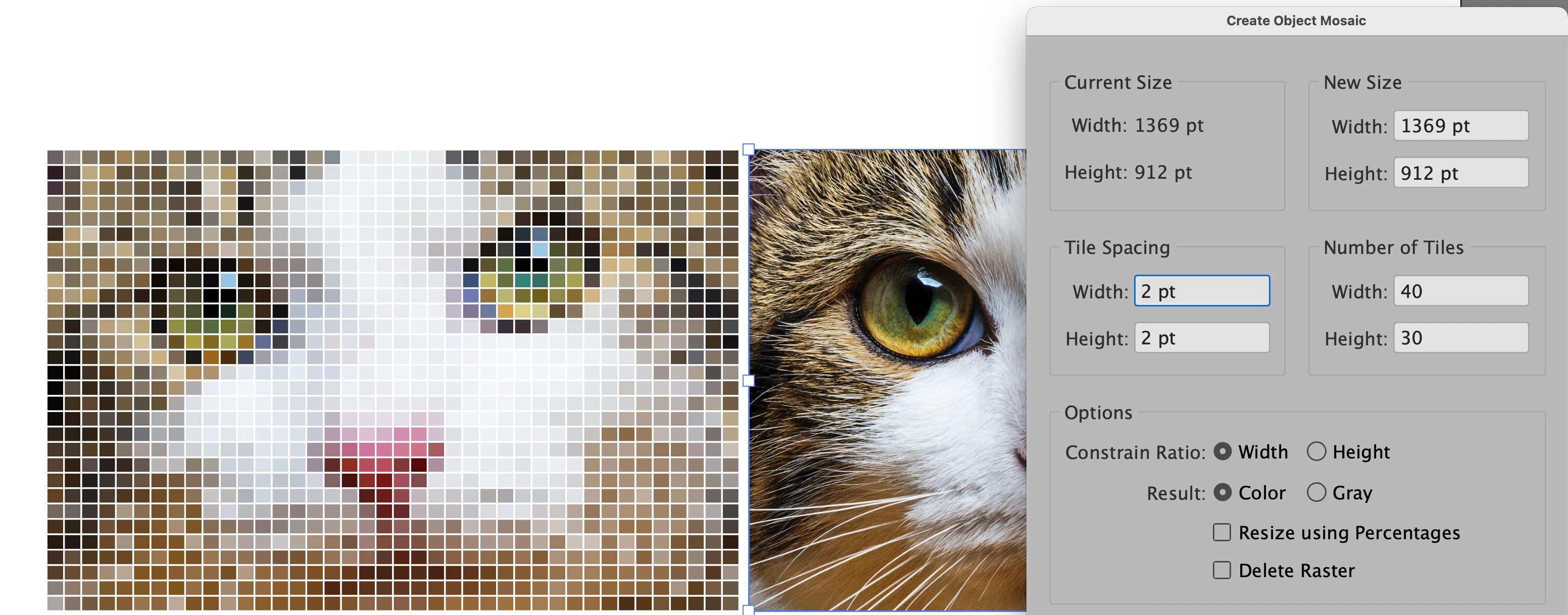

Someone else will probably chime in, but in Illustrator you go to Object > Create Object Mosaic. You may have to do some math to convert "number of tiles" to 10mm x 10mm.

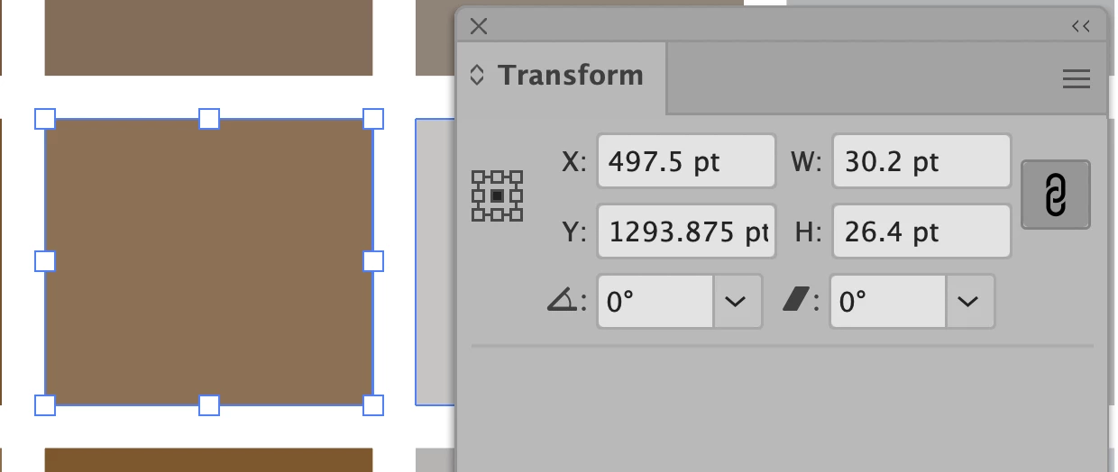

I don't know how big mm is, as my country tried to use them for a couple of years, then gave up. You'll have to do the math to figure out number of tiles. Or use trial and error. Choose something and look at the size of the tile, then choose something else.
I was about to come back to add some things:
  • If it's vector, your will need to rasterize it befor you use Create Object Mosaic
  • By default, it will keep the original, so hide and lock it
  • It creates a group of the tiles
  • Your title is "Can I set the dimensions of a pixel when I pixelate/mosaic an image?"
    Raster images are made of pixels, which you can see when you zoom in. I think you mean "tiles", not "pixels" here. You can set the dimension of pixels when you print by saying you want 10 pixels per inch (10 ppi), 72 pixels per inch (72 ppi), 300 pixels per inch (300 ppi), etc., but that only applies to raster when printed.
  • In my example, one tile is 30.2 pt x 26.4 pt.
