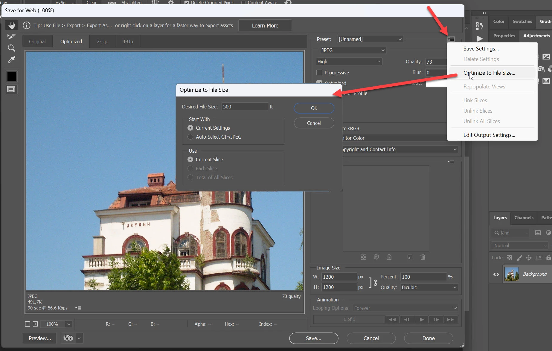

If 8 quality is a must then I do not know whether is achievable. You have File > Export > Save for Web > Optimize to File Size to skip guess work if you want images for web.

Hi @Ioannis29153592vhuh you will have to change your resolution on your image - 1.2 mb is the maximum compression that you will get with these dimensions. The actual document size is 4.3 mb so 1.2 is a pretty good compression rate.
If you are trying to save these for web you'll have to adjust your image size to get to 500 kb with something so large.
