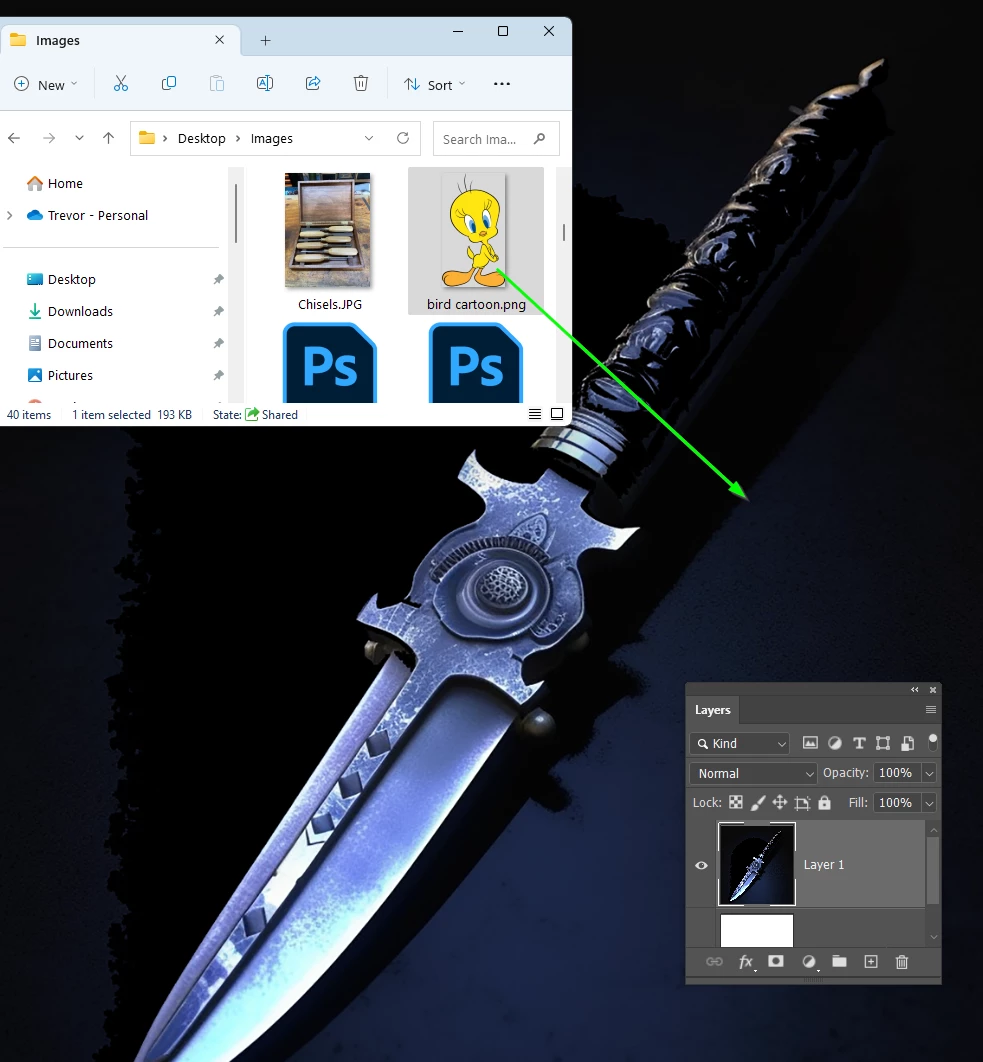

I would strongly advise you NOT to be messing with the Windows Registry for something like adding an image to an open Photoshop document.  What is your exact workflow for doing this?  If you have a single screen, you should be able to drag File Explorer onto the Photoshop window, but reduced in size so you can see Photoshop behind.  Make sure the file you are dragging is a valid image format (i.e. .JPG .PNG) and drag with the mouse.  I have File Explorer set to Large Icons to make this easier.

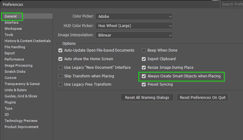

It's a good idea to have this Preference setting enabled as you have more control of the image when it gets to Photoshop.

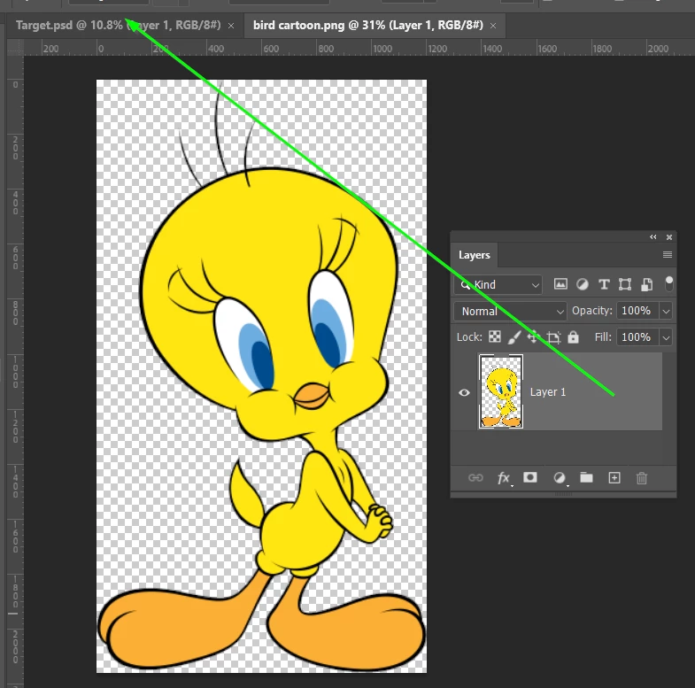

Open both the target and source documents in Photoshop (Note I have named the documents to indicate Target and Source)
The images need to be tabbed to the options bar which is the default.
Select the source document, and drag the layer (background layer if that's all there is) to the Target documents tab as per the green arrow.
Pause for a moment, and drag it to the image window and you aRE DONE
