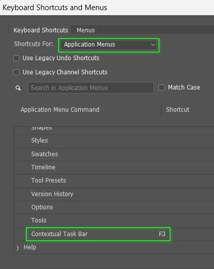

The way I retrieve when it plays hide-and-seek in the beta version is turn it off and on.  You can give it shortcut which is something I find useful.  It definitely likes to hide itself, and tapping F3 (in my case) makes it flash off and on if it is just in a corner somewhere.  IIRC clicking on Generate can turn it invisible, but I am nearly always using the beta version, which might be different.  When that happens I might have to toggle it off and on several times to make it stick.
