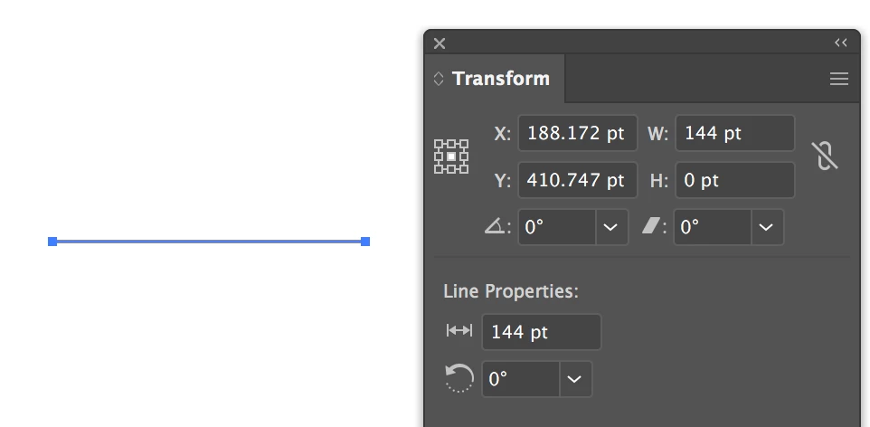

jane-e
Jan 14, 2019 8:11 PM UTC
I can't reproduce it. Shift constrains my lines as it always has. What does it say in the Transform panel?
