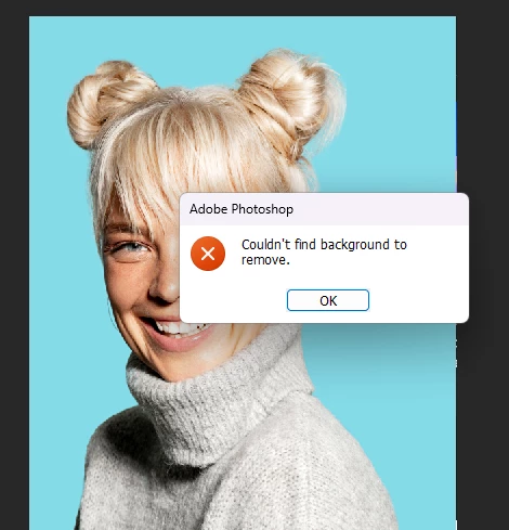

Does anyone know why all of a sudden (it came out of nowhere, but I've been dealing with it all month) I am getting a Couldn't find background to remove when I try to use the Remove Background tool?

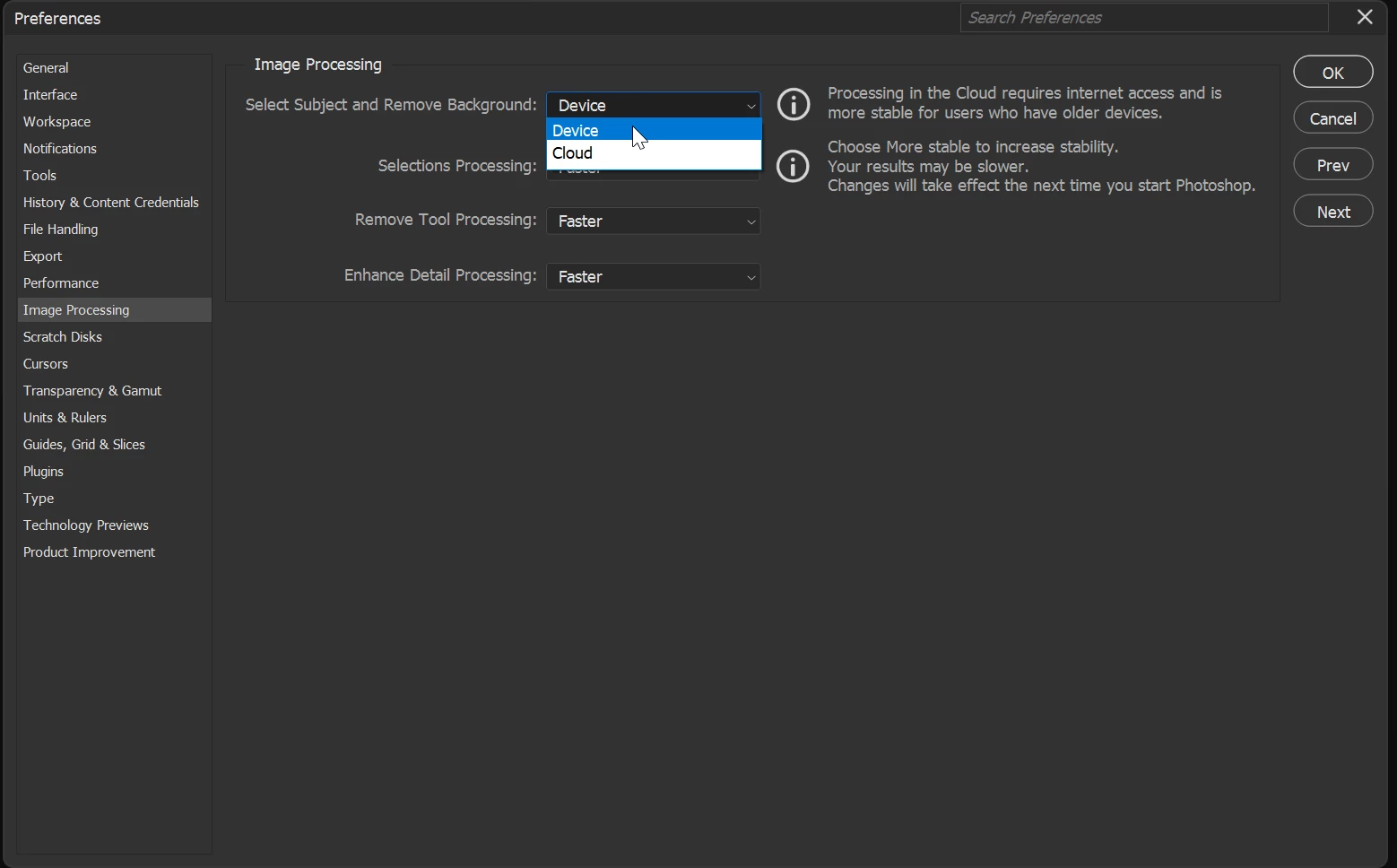

Logged out, logged back in, tried remove background again and still got couldn't find a background to remove message. Strangely enough, I went back to preferences and switched from Device to Cloud and then Remove background worked so.....I'm all confused now

I am wondering if you weren't on a blank layer? (It happened to me and I had a sort of brain fog, got frustrated until I figured out it wouldn't work except on a standard layer or a smart one)
In case it's not that, can you share the whole window? (with the layer panel visible)
That way if something clicks, we will be able to see it...

Do ya one better, here is a screencast: https://go.screenpal.com/watch/cTXrDDnqqFE
Imaginerie
Nov 21, 2025 6:10 PM UTC
Thanks, it helps a lot. First of all, it shouldn't be happening, the feature should work even on a locked background (I tried, just in case, as I rarely work directly on the background ;ayer). I don't see anything that be a cause of concern in the screencast.
Stupid question: did you try with another image?
The only other thing I could think of on the top of my head would be a glitch in the CC syncing.

@46847751 try setting this option to device rather than cloud in the PS preferences
Nov 21, 2025 3:19 PM UTC
Hey, first of all thanks for the reply, but it was already set to Device, see here:
