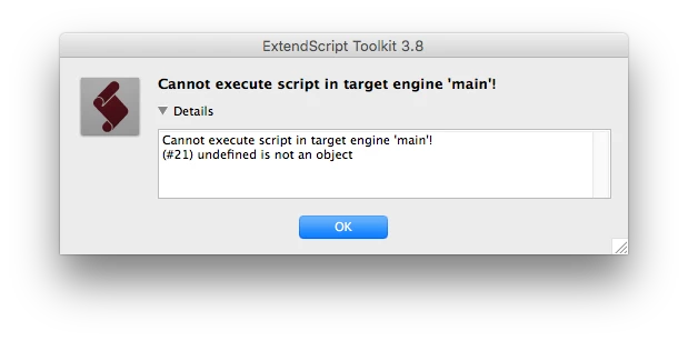

Nov 22, 2018 8:41 AM UTC
Hi Tom,
I get the below error:
Tom Winkelmann
Nov 22, 2018 9:41 AM UTC
Because you edit the file with ESTK (which uses the 11BTBackend.jsx)
You can edit the file with ESTK, but you have to save it with a different filename or to an other location. Then close ESTK and delete/rename the original jsx and replace it with the new one or rename the new one with the original name.
You can also edit the file with another editor (but you have to close ESTK in the meantime).
