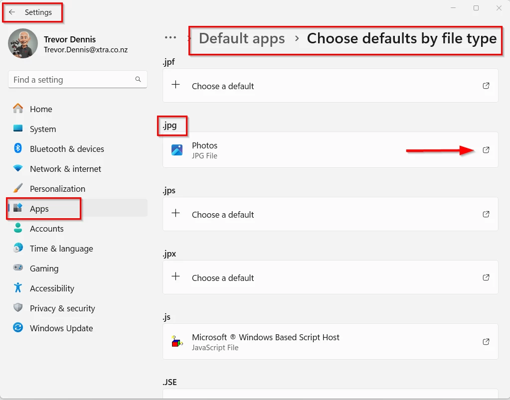

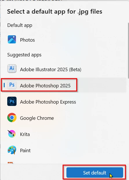

Trevor.Dennis
May 26, 2025 11:08 PM UTC
Have you tried setting it in Windows Settings?
Settings > Apps > Default Apps > Choose by file type > click on box (my red arrow)
Choose Photoshop > Set Default
You can also set defaults from Bridge Properties.
