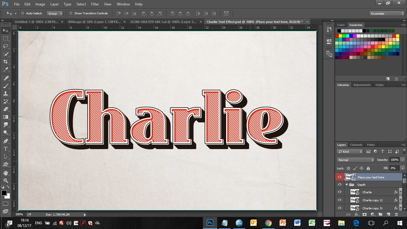

    Double click here (inside the green highlight area)
    The layer will open in a new window. Move to that window and edit it.

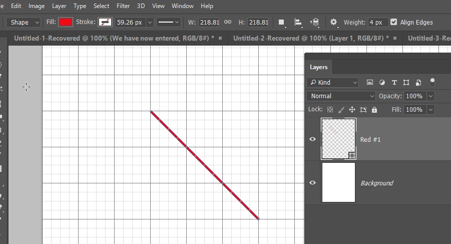

    Create a new document, and turn on the Grid.  Make sure Snap is enabled under the View menu
    Use the line tool to make your first line as below.  Holding down the Shift key will force the line to 45°.  You can see I used a 4 pixel line thickness. It is important that you go between the grid points so that we can make a seamless pattern

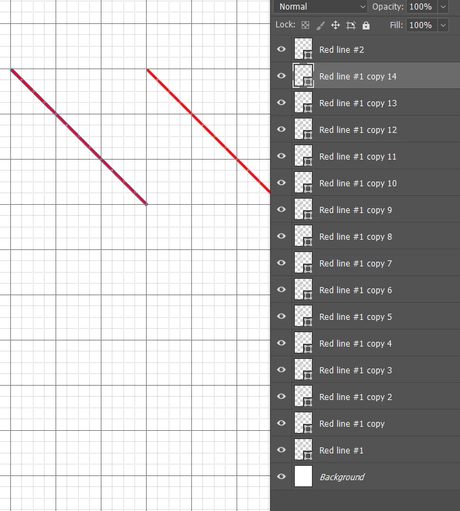

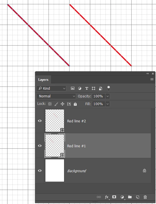

    Run a second line three major grid segments across

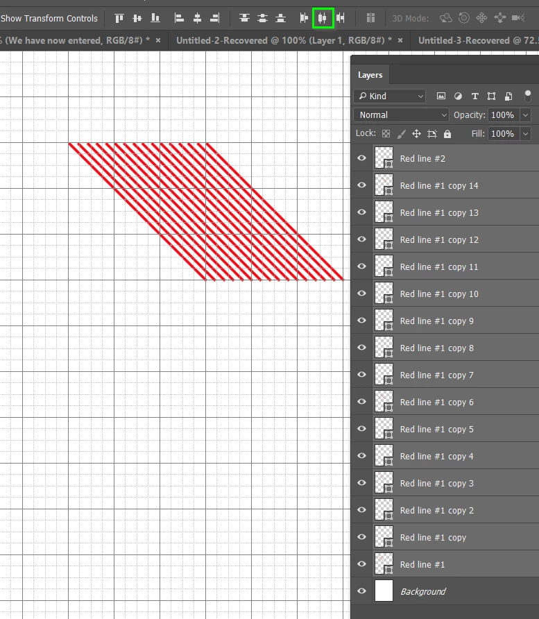

    Now you need to decide on the line density.  If you want five lines per grid, then you need a total of 3 x 5 +1 = 16 lines
    So copy Line #1 14 times
    Select all 16 lines and the Move tool, and use the align tool in the options bar to equally space out the lines
    Nearly there.

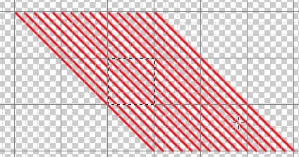

    Make a selection with the Rectangular Marquee tool using the grid square I have shown below, and letting it snap to the grid.
    Note: when we define the pattern, it will use all pixels inside the selection, so turn off the background layer
    You can just about see the marching ants below.

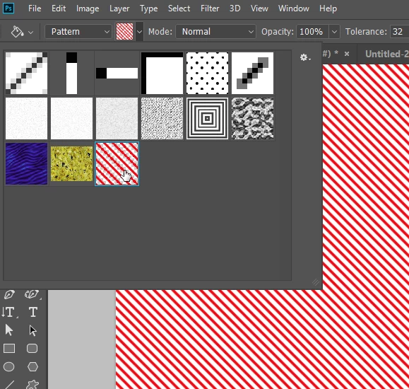

    When you have the selection go Edit > Define Pattern and give it a name
    If you select the Paint bucket, and use the drop-down to change from Foreground to pattern, you should see your new pattern.  Try it on a new layer.

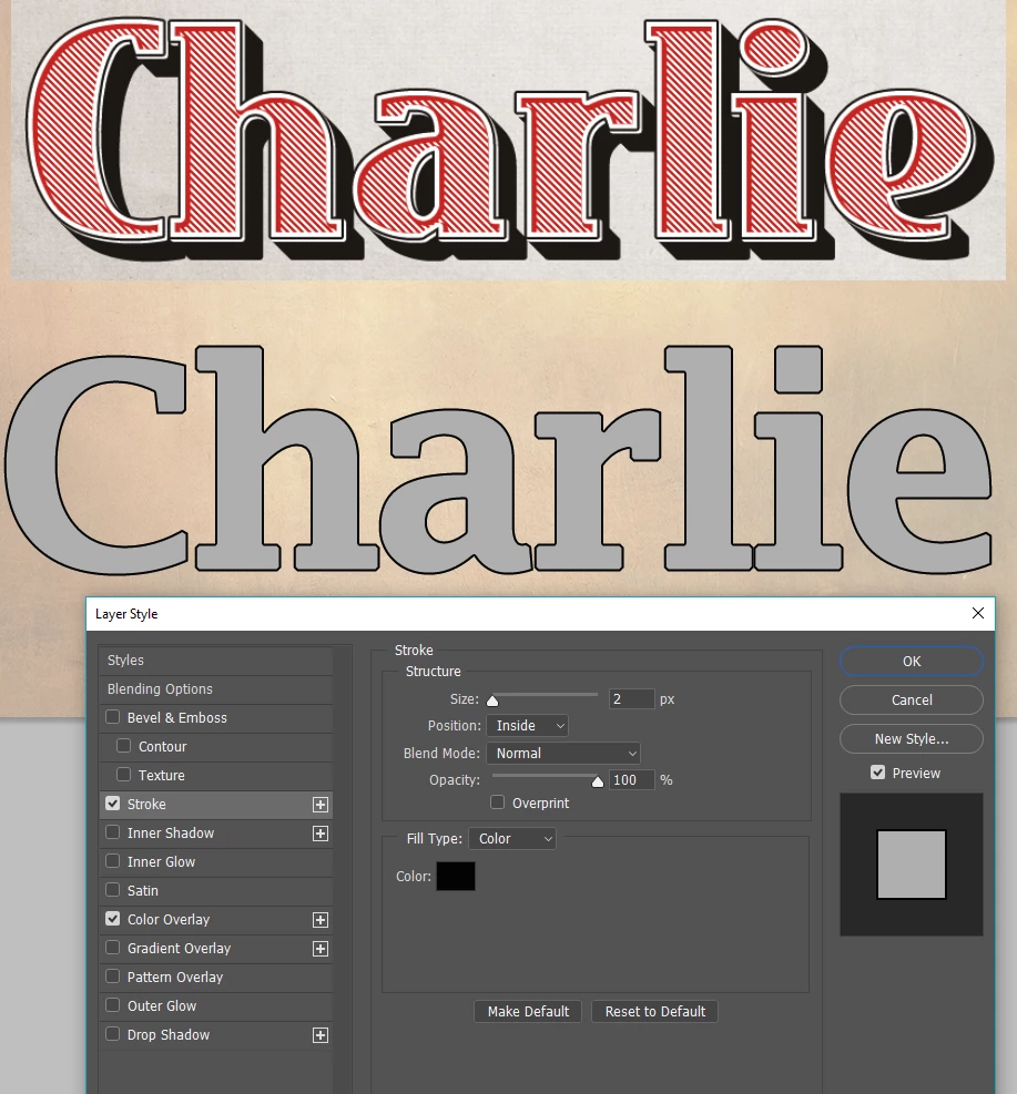

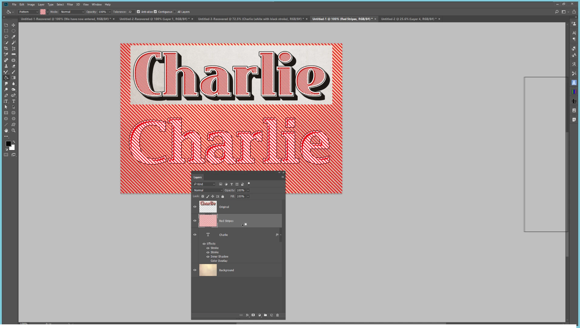

    Now go to your Charlie document, and lay down the text layer in white (Note: You need CC2017 or later for this)
    We'll use use the stackable Layer styles that came with CC2017 (I think)  These work just like Photoshop layers.  Styles at the top of the stack in Layer Styles, hide those beneath them, so the thinest (inside) stroke has to go at the top, and thicker (inside) stroke appear by protruding out from beneath them. Like this
    So getting back to the Charlie graphic, I have pasted the original so we can see what needs to be done.
    Double Click to open Layer Styles and add a 2 pixel (or whatever suites) stroke with it set to inside.
    Note I have added a grey colour overlay as a temporary measure so we can see what we are doing.

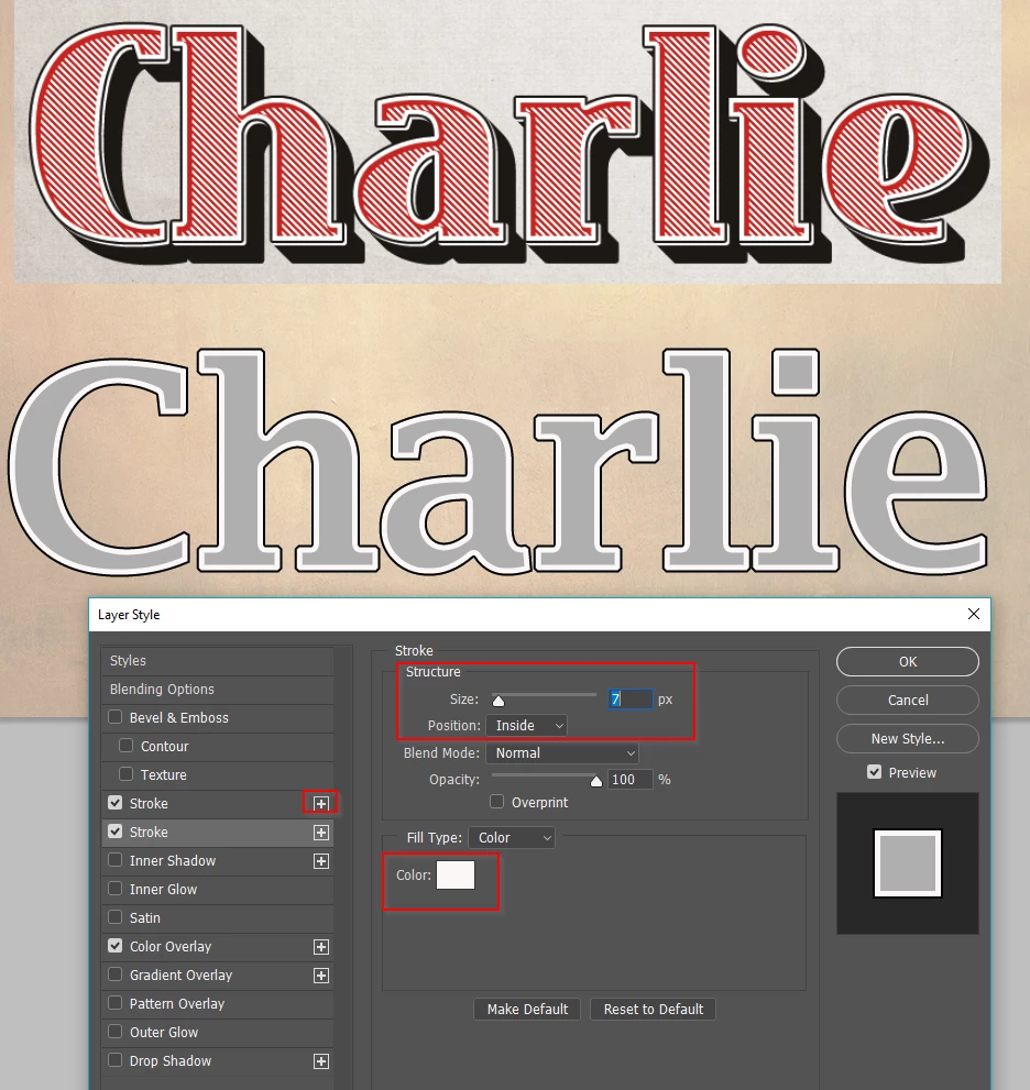

    Click on the + to create another Stroke, and select the lower one.
    Make the colour White, and increase the size to 7 pixels (or whatever suites)

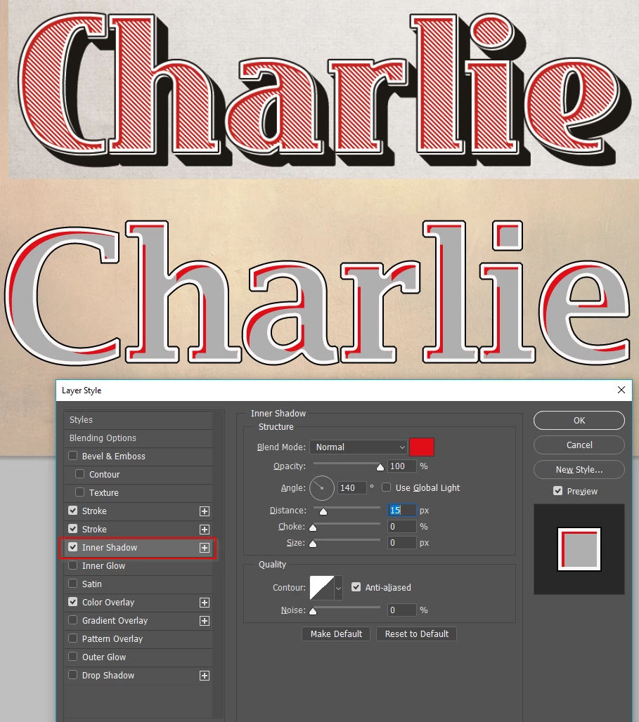

    Now add an Inner Shadow using these settings.
    The default blend mode is Multiply, and you might find Normal works better.
    It is important that Size is set to zero to prevent the red shadow being blurred.

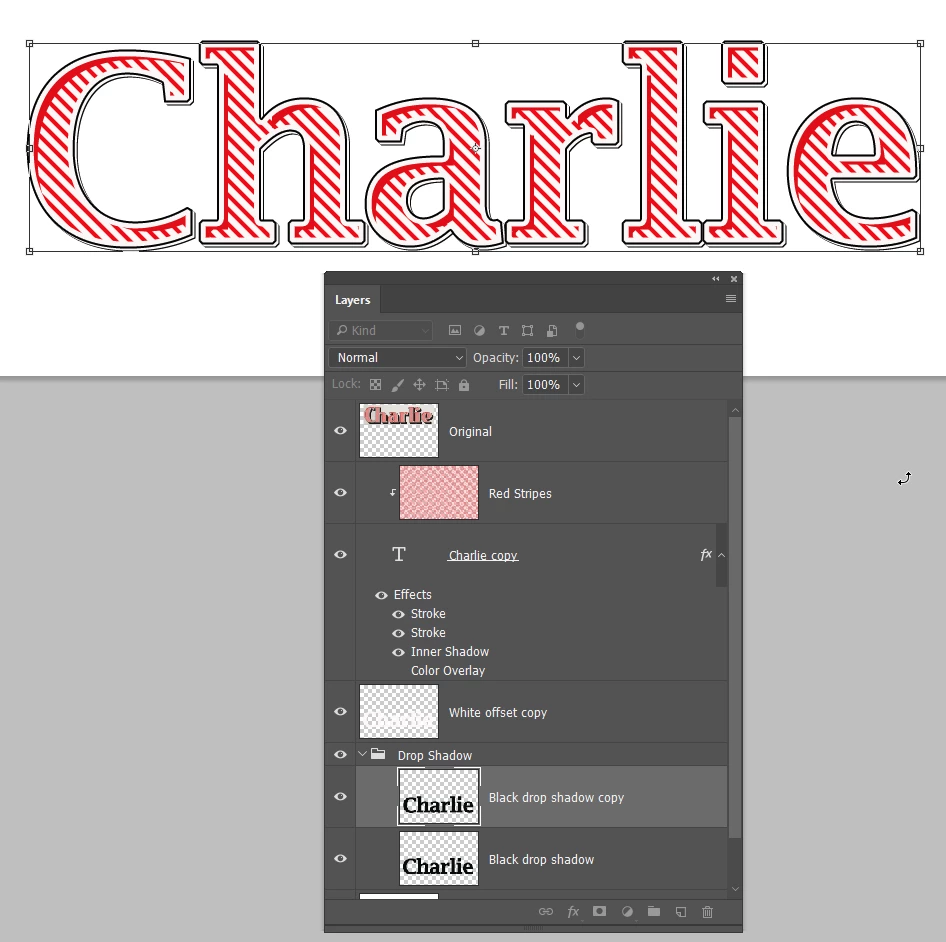

    Make a new layer above the Charlie text layer, and chose the Paint bucket, set it to Pattern, and fill the layer with the red strips.
    Then hover the intersection between the text and red stripe layers, hold down the Alt (Opt) key and click to clip the layers together.
    You won't see anything initially, so turn off the Color overlay by clicking on its eye icon

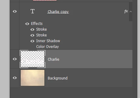

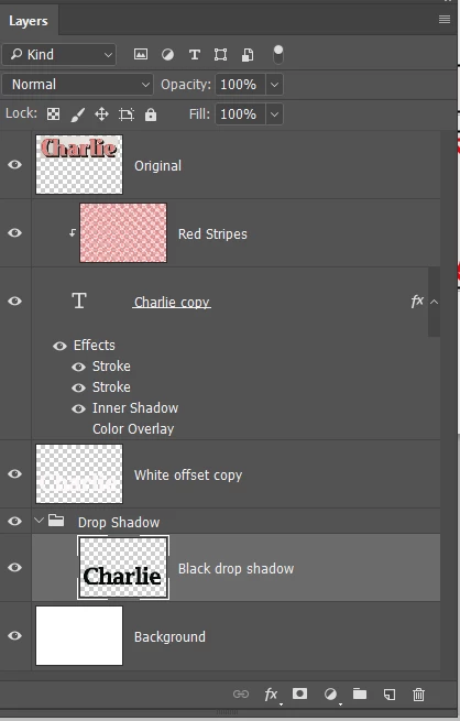

    Copy the Type layer, and select the lower on in the layers panel
    Right click over the effects, and chose Clear layer style
    Then right click again, and choose RastyerizeType.
    Select the Move tool, and use the cursor keys to move the layer two pixels right, and two pixels down
    I have made the background black so you can see what we just did.
    Now we need to use a trick called Free Transform Step & Repeat.  It can be a bit finicky, and does not play nicely with Smart Objects, so avoid using them, and set the Work space to Essentials if not already selected.  This gives us the best chance of making this work.
    Copy the rasterized type layer, select the lower one and use Ctrl G to put the layer into a Group
    Use Ctrl i to invert the layer and make it black.
    Copy the black layer again, and start Free Transform.
    Move the layer 1 pixel to the right, and one pixel down, and OK the free transform
    Now for the Step & Repeat
    Hold down Shift Alt Ctrl and hit the T key as many times as you need to create the drop shadow
    Job done
