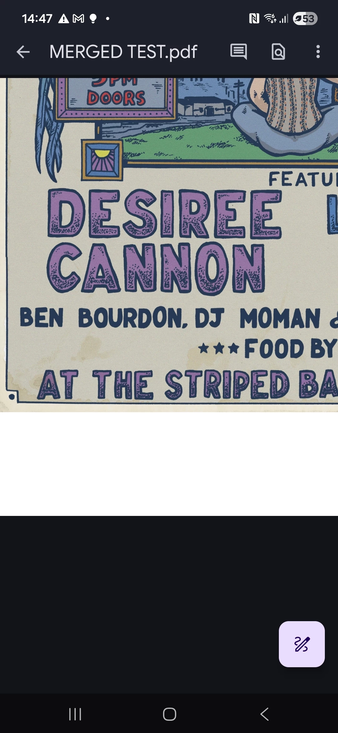

Hey, I have an issue with Photoshop 27.9.1 where I'm saving an image and sens it to a client it cuts a lot of the image off. I think if its opened in photoshop it is ok, but I have sent the copy to a printers and they said they cns only see half the image. your advice hasn't fixed the problem. any ideas what else it could be? please see what I receive when emailing to myself
Srishti Bali
August 24, 2026
Hi ​@hopeful_Ripple2cb7 ,
Thanks for reaching out. Could you please confirm whether this issue is occurring with all images or only with specific ones?
If possible, please share a sample image where you're experiencing the issue. Also, please provide your device details, including the device model and operating system version.
Thanks, Srishti Bali | Community & Engagement Strategist, Digital Imaging | Adobe

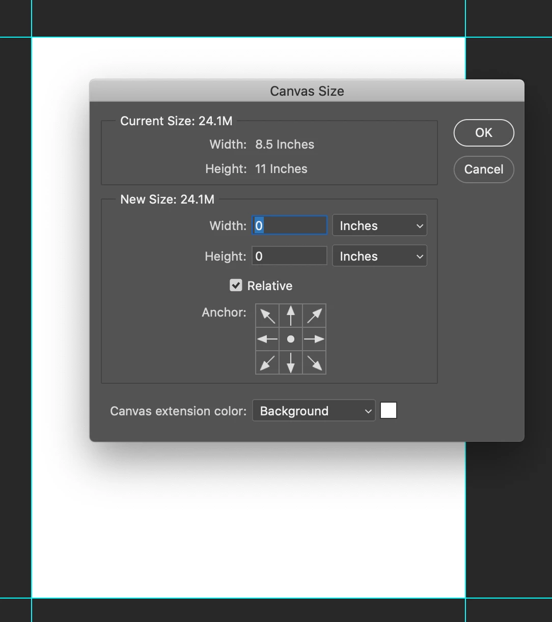

September 8, 2020
I have a similar problem. Say for example I create a 8.5" x 11.0" canvas. I was wanting to change the size to be 8.75" x 11.25" and it created a huge canvas. I'm seeing the problem to be that the new values are default at zero and zero. I've found that if I were to only put in .25" x .25" it will add those values to the width and height, then the new canvas size will be 8.75" x 11.25".
I don't understand why now I have to do calculations to change my canvas size!?
I'm using version 21.2.2 on Mac. It was this way on the previous version, I just updated to see if it would address the problem.
Conrad_C
September 8, 2020
Your issue is slightly different, and it is not really a problem. In your Canvas Size dialog box, the Relative option is selected. When Relative is selected, it defaults to 0 (no relative change), and what you enter changes the canvas size relative to what it is now. So entering 0.25 means add 0.25, instead of set it to 0.25.
It sounds like at some point Relative was selected even if you did not intend to do that. To make it work so that the values you enter are absolute instead of relative, deselect Relative.

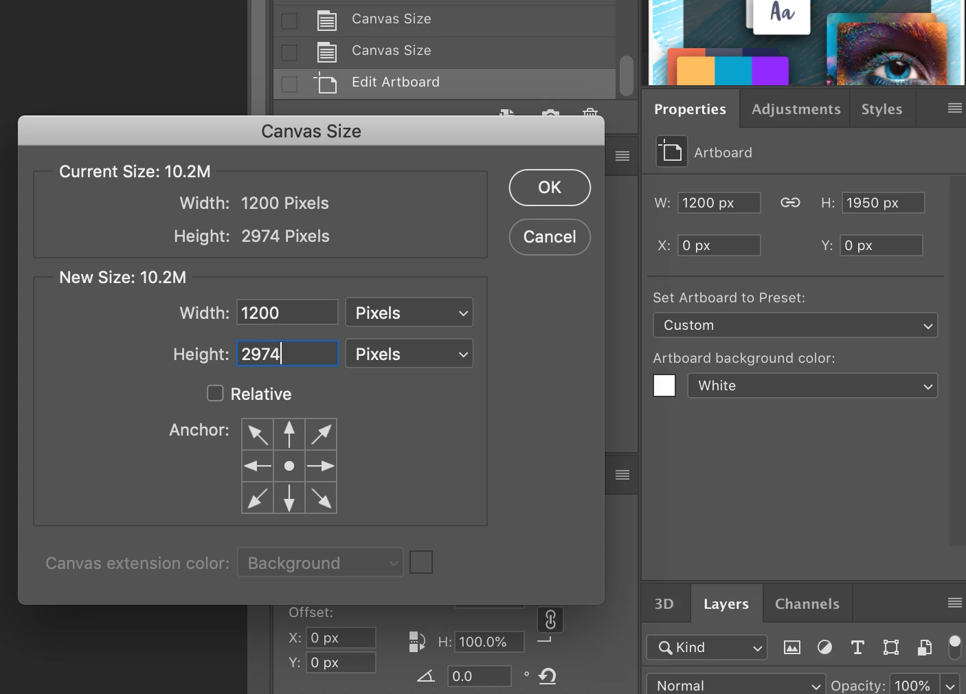

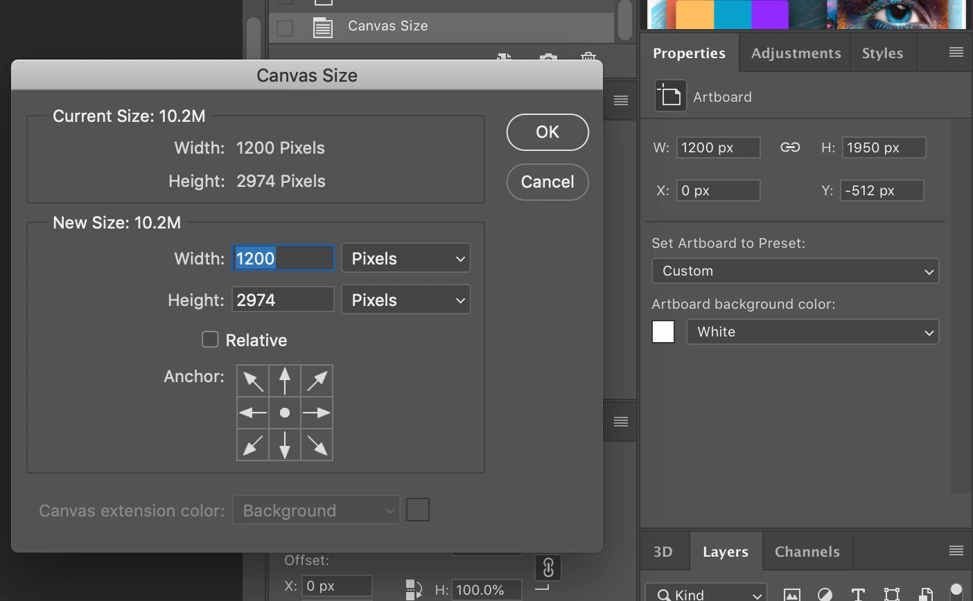

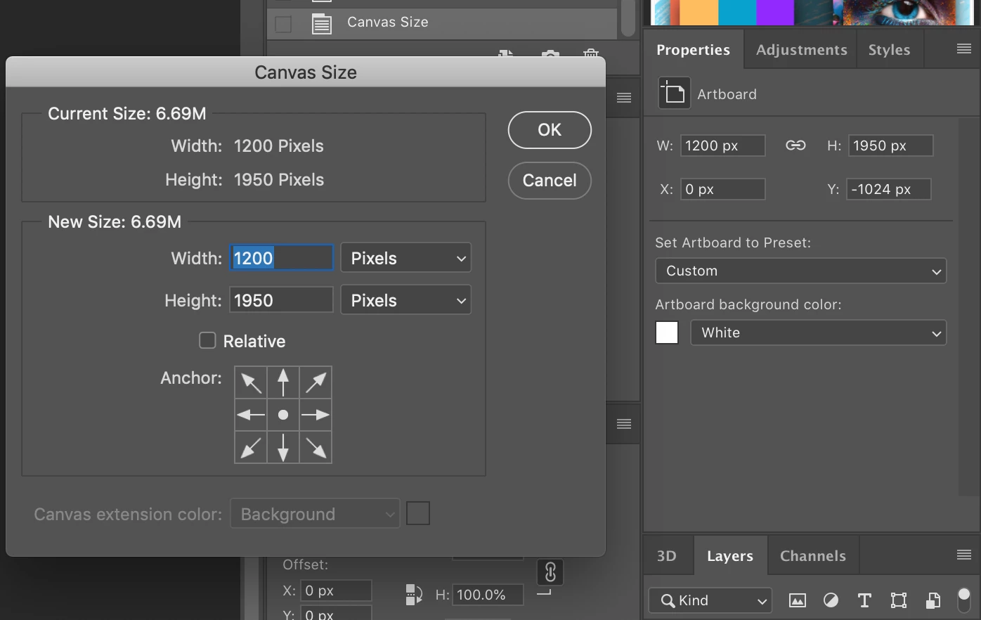

Follow up: The problem is happening to a new file. I've tried checking to see if there are any elements outside of the artboard boundary - nothing there. I've also noticed that the default for the artboard Y placement is at -457 px and every time I change that to 0 it goes back to -457 px or another random pixel amount once I try to adjust the canvas size.
I've attached some screenshots with some of the different occurrences that are happening. All with the height of the artboard, not (currently) with the width. Note that the placement should be at 0,0 and the height at 1950 px. Note, these screenshots were taken one right after another, each after adjusting the artboard placement or the canvas size, one right after another.
If anyone has any other recommendations for how to fix it, let me know!
