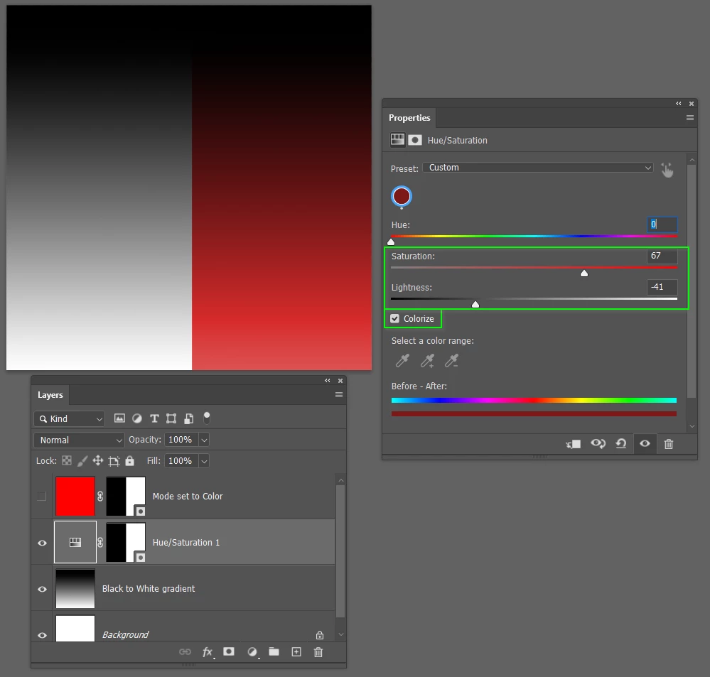

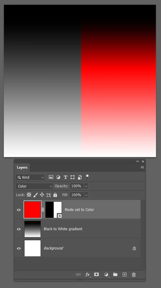

Trevor.Dennis
Jun 10, 2025 4:34 AM UTC
It depends on the underlying tonal value.  Full white and full black will show no colour. 50% grey shows full colour.
I have used a black white gradient to demonstrate, with a mask over half of the canvas to show what is below the layer set to Color.
If you use a Hue/Sat layer with Colorize checked, you can control the underlying tonal value with the lightness slider.  You can only control one end of the tonal range with the one Hue/Sat layer though.  You can see I have darkened the whites below.  You can chose any method you like to control those tonal values.
