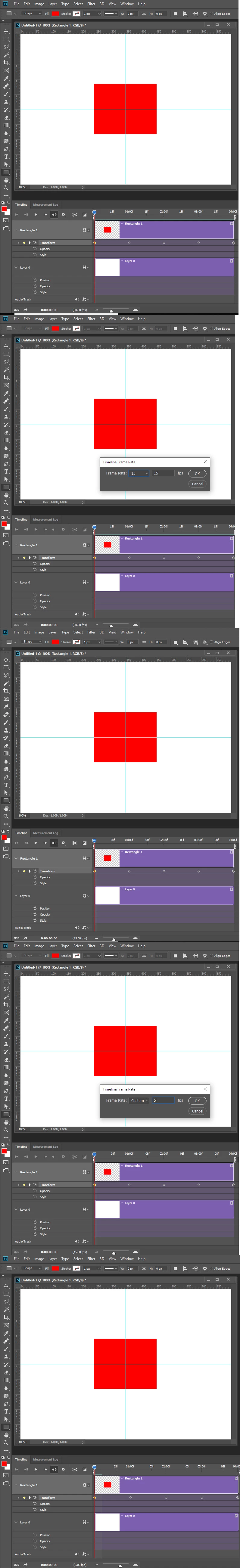

JJMack
January 28, 2019
Some how the second Post I posted dropped and series of screen captures I included in the post the shoed when I changed the frame rate in a video timeline.  The default 30FPS  for a 4 second video Change to 15 FPS after I click OK the next screen capture showed 15 FPS.  I the changed it to a custom 5 FPS.  After I click OK the next screen capture showed 5 FPS.  In all Screen capture the video duration remained  a constant 4seconds.  The time scale size change not the time.  I spread it out so it size would display  about the same size on screen.   That is why I suggested resetting Tools and user ID Preferences.   You animated gif seem to show you video duration was being changes.   That should only happen when you drag on the end of the clip to change its duration which would not change the  frame rate.

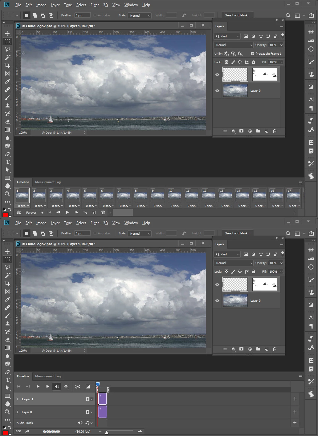

January 27, 2019
The number of frames should change if the video duration is the same.  Frame Rate A  times duration will not be the same as Frame Rate B times duration.  The durations should be the same the frames rate should not be the same. If the number of Frame remains the same the Duration should change.  It looks like you are seeing the duration is changing when you make the change. You are seeing  (Same number of Frames)/(different Frame rate) = (Different Duration) the video duration time is changing.
There is a big difference between a Frame Animation Timeline and a Video Timeline.  You show a video timeline the horizontal layout is Time. and a single frame rate In a frame Animation timeline the horizontal layout are frames they can have different durations set.
