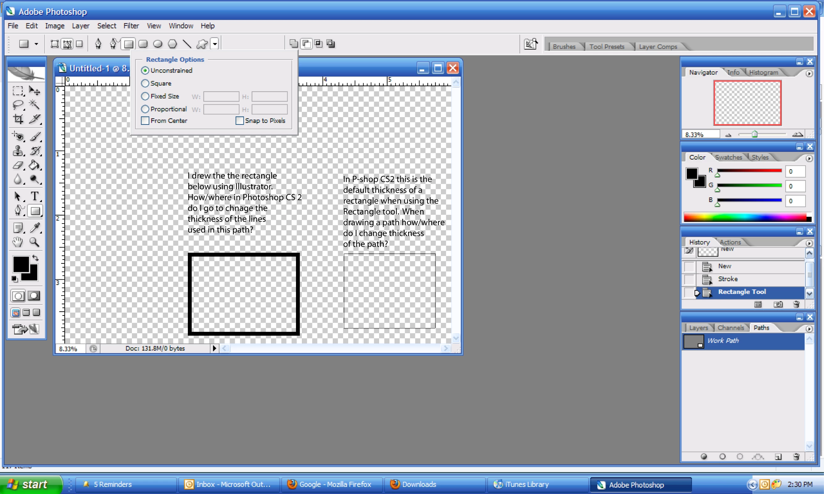

    This depends on how you are using the Rectangle tool. You can set this in the Option Bar.
    If you're making a Shape, you need to change the size in the 'Stroke' field of the Layer Style.
    If you are just making a Path, choose a desired brush size, and then Stroke the Path.

    I am making a path.  That said, in Photoshop CS2 I don't see where I can select a brush size once I have selected the Rectangle Tool to increase the desired thickness or weight of the path for that rectangle.  Since I am creating a path why would I use/select a brush size?  I have attached a screen shot which shows what I am seeing when I select the Rectangle Tool and attempt to change the thickness of the path. The attached image aslo shows what I am trying to accomplish.  I don't see where I can select the weight or thickness - even when I right-click with the mouse, etc.  Even if I try to change the Style from the Option bar it seems overly complex for such a simple task.
    When using the Line Tool in Photoshop CS2 you do have an option to change the line thickness or weight but when I click on the Rectangle Tool that option for changing the the line thickness or weight disappears.
